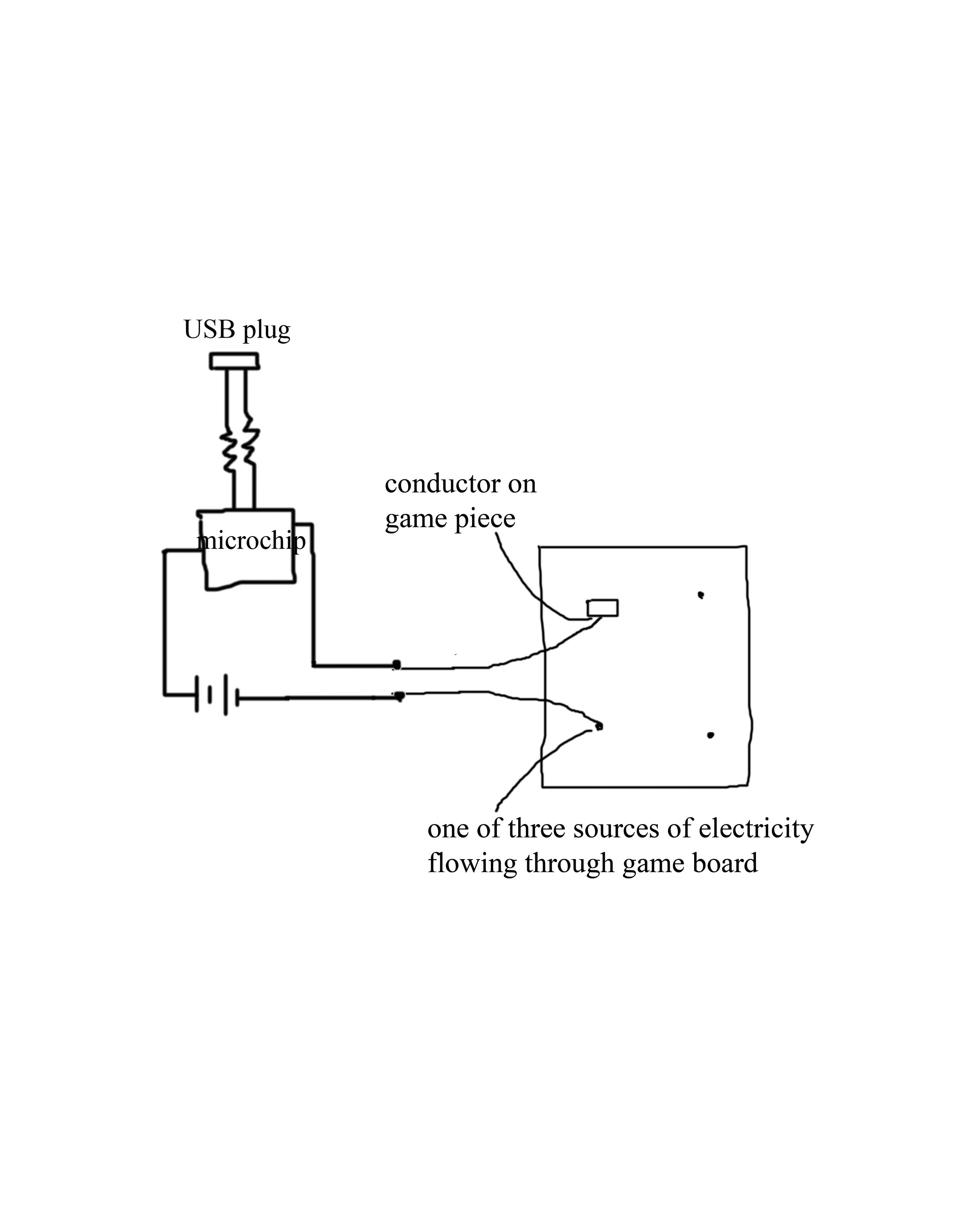

I have been watching this thread and I need you to clarify this for me.
To simplify things lets look at the problem in one dimension instead of two. It can be easily modeled with a variable resistor. The voltage of on the wiper in respect to ground indicates where the wiper is on the resistor.
The problem is "in respect to ground". A game piece has no ground. Even if it did how are you going to get a signal back to whatever it is that will read it?
How large is the play area ?
Right now I’m working with a model in which the game pieces are a little cumbersome because wires that are used to communicate the pieces’ properties – and that could also be used to indicate the pieces’ positions instead, connect to each game piece and run across the top of the game board to terminals. I intend to complete the circuit using a schematic similar to the one attached – which I still need to review. The signal may be varied according to an amount of resistance that I am hoping will vary somewhat consistently with respect to a distance between the game piece and each source of electricity on the game board labeled in the attachment – if and when I find the right material to make the game board out of. The play area is about two feet by two feet.
