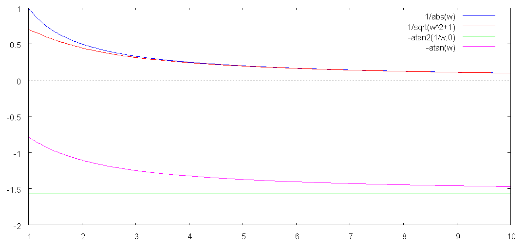

This is an old old thread, but here is a graph of the two. The main differences are the amplitude is very different at DC and similar at higher frequency, and the phase is constant for the integrator and varies for the LPF near DC, and they are both constant for higher frequencies.
A striking difference is the integrator has infinite response to DC, while the LPF has finite response.
blue: integrator amplitude
red: LPF amplitude
green: integrator phase
violet: LPF phase
