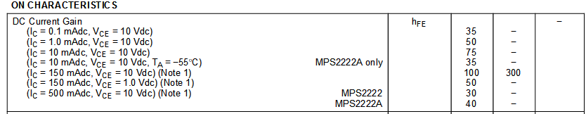

Good Design:
Parts have minimum/typical/maximum numbers. Often min or max is not on the data sheet.
If you build one of some thing then you change things until it works and done.....
If you build millions......you really need all the parts to work.
In the testing phase you probably can not get min or max parts.
A transistor's current gain has a large difference between min and max. (max might = ?)
Too many times we have received "max" parts for a year then suddenly you have 10,000 "min" parts.
For years I used high current high voltage capacitors. In some designs +/-5% is a little hard to deal with. The +/-2% parts are more money.
What I noticed; some times a batch of caps would all be -5% to -2%. Then the next batch is +2% to +5%. What I found is that some one grabbed all the +/-1% parts. Then most of the +/-2% parts are removed. Through some negotiation I found I could get the (-5%) caps for the same price as +/-5%. (which usually was -5% to -2%) I have bags of 1000V caps marked (-) and others marked (+).
Example: MPS2222 transistor, current gain, min and max. 1:3 range. (at 150mA only)
