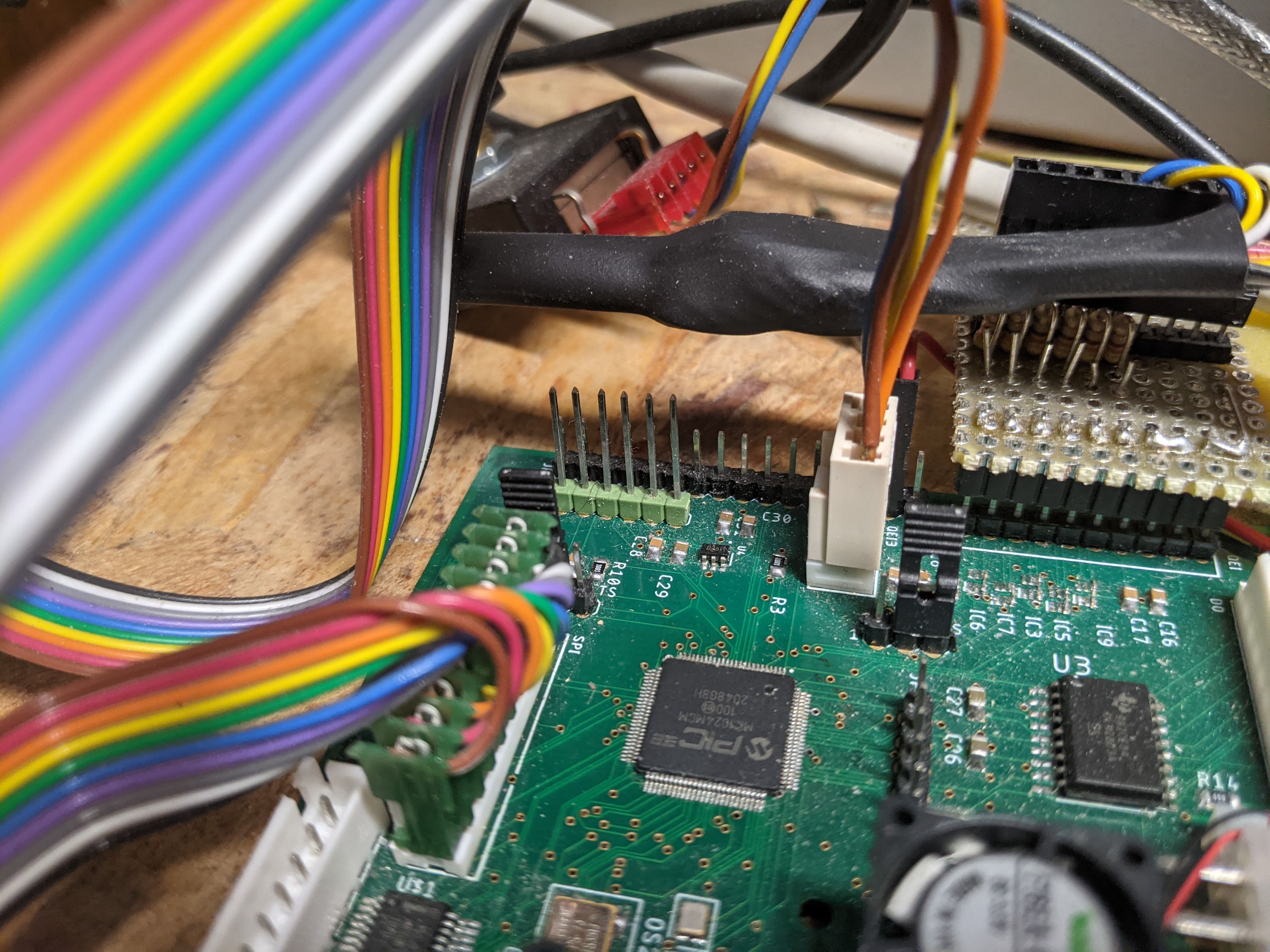

I just ordered a PicKit4 to use with 18F27Q10. What kind of connector does the target board need to interface with the debugger? (Looks to be a Molex in the picture.) Anyone have a part number and recommended vendor?
Bob D.
I use RS Components 745-4845 (straight pin) or 479-018 (right angle pin).

I would suggest using 6 pins rather than the minimum 5 needed (so you can't as easily get a PK2/3 on incorrectly, or even 8 pins if you're only goping to use a PK4. Personally I stick to 6 pins regardless of PK2/3 or PK4.
I also have a few simple veroboard adaptors I built - with male and female pins/sockets, as straight and right angle extensions, which come in handy.
On PCBs I use a JST 6 pin connector and on breadboard a straight 0.1" male header.

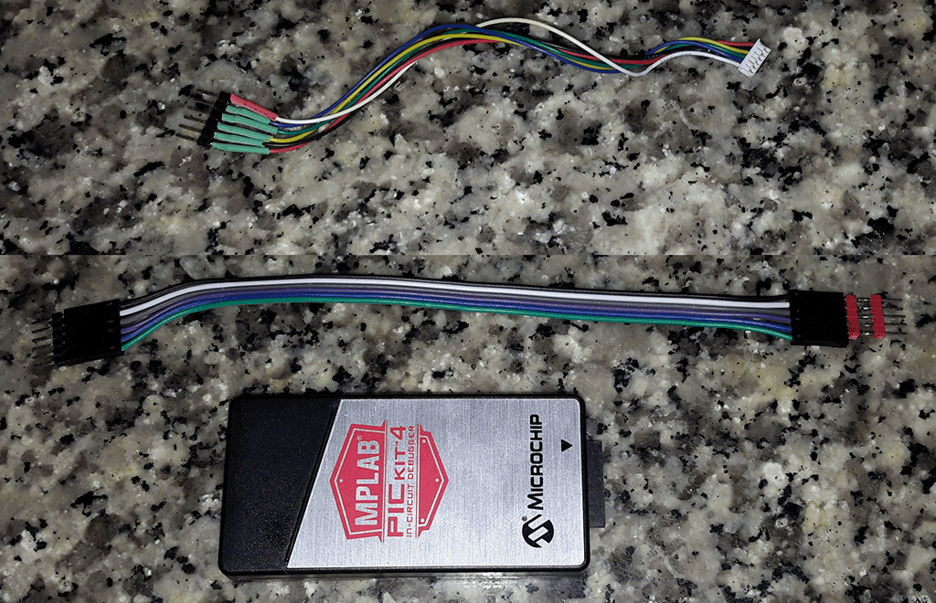

Here's the lead that the pickit4 comes with and (above) the lead I made with the JST connector.
The bit on the right of the supplied pickit4 lead is my adapter to fit breadboards.
The JST connector takes up much less room on a PCB but being 1mm pitch, I only use them on premade boards.
I don't recall any lead coming with either of my PK4's?.
I like the single red heatshrink on your JST lead - makes life a LOT easier.

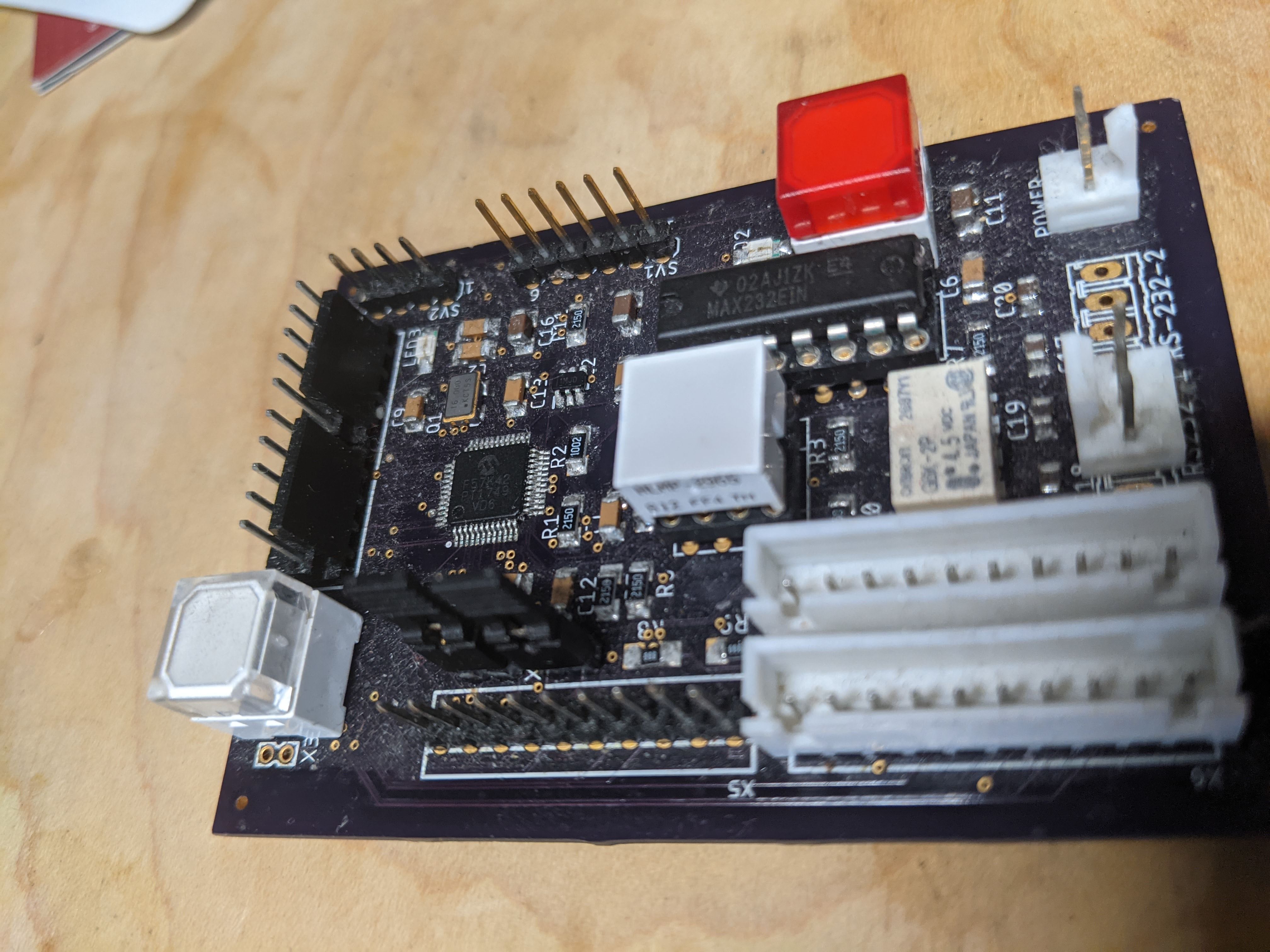

On my TAP-28 dev boards, I use 6 pin 0.1" headers for ICSP, UART and I2C/SPI connectors with any extra pins having I/O pins connected via solder jumpers. There are all connected with the same power/ground arrangement as the ICSP connector, which I have found to be tolerant of the "oops" of plugging in the header backwards.
For the short period of programming, a header can be inserted in the ICSP location and held at an angle to make good contact if installing a header isn't desired.
A handy trick with a PICkit 2 (call me old fashioned) is to set up a software UART, with the pins corresponding to those used in the PICkit GUI UART tool. Load your code, then switch to the UART tool to monitor code progress without the need to change connections or other hassles.
Using the 6 pin connectors, if I2C or UART isn't used, gives me 4 I/O pins (3 on the ICSP header) that can be used for general I/O with the ability to easily switch functions between connectors if needed.

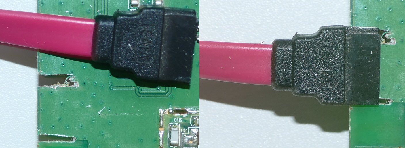

On the other hand, a few standard 1.27mm pitch tracks, a couple(*) of slots and a sata 7p cable will plug on and off easily and provide a reliable connection.
(*1 slot if you position it at a corner of the board.)
Crudely approximated:
Cheap (especially if you've a few dozen of these cables lying around in your bits box) and simple; requiring little or no more board space than a pin header.
