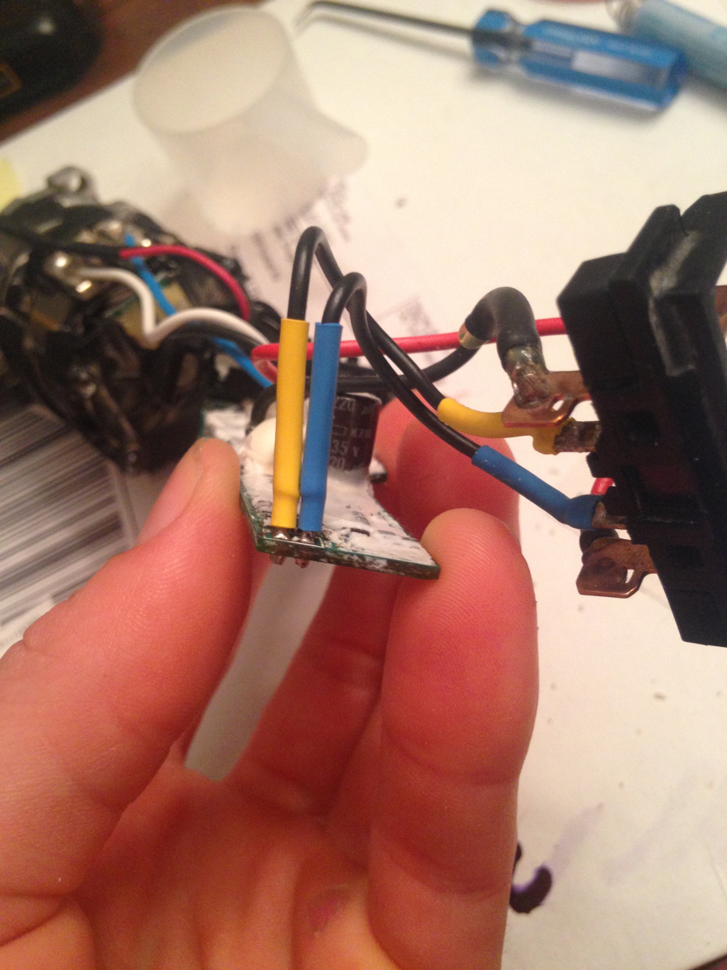

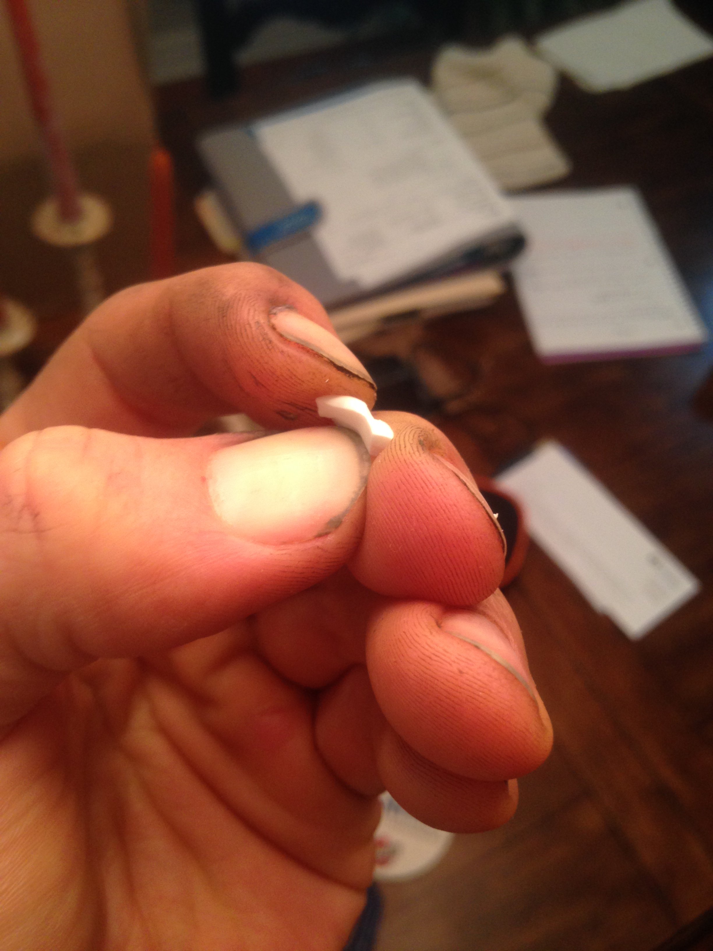

Hi, I just got done making a repair on my Dewalt DCS355 oscillating tool and am trying to find a similar coating/adhesive that was used.
It kind of has qualities similar to silicone but it's breaks easier if you bend it. I need something similar to this because it is what glues the circuit board down to the case it was in.
Thanks in advance for any help.

There are many different kinds of silicone. Are you sure it's not just the kind of silicone that does not produce acetic acid when it cures and is thus non-corrosive and intended to be used with electronics?
RTV162 and it's expensive because it's meant to hold down components onto the PCB.
RTV1035 might be the kind that's more suited for the purpose you're looking at, and cheaper.
Conformal coating is a thin coating used to protect boards from moisture and vibration. It's not intended to adhere anything together.

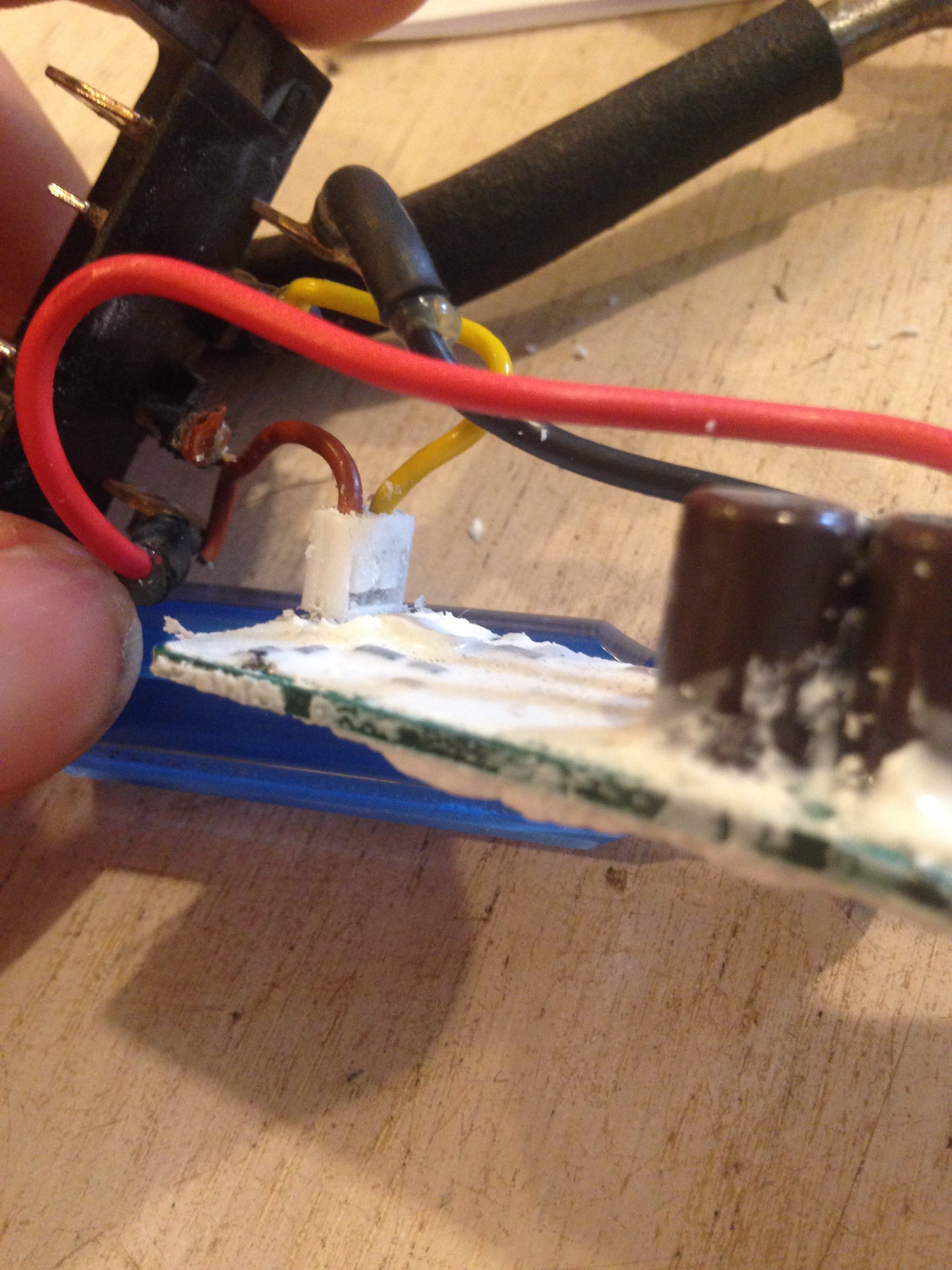

Ok. There is also a clear silicone like coating that is on the board too. If I made a solder repair job, should I put some more of this coating also?
That clear silicone coating is the conformal coating. If you repair it you could replace it with more silicone conformal coating. It's up to you and whether you just use your drill indoors ocasionally or on a wet dirty work site.
You should be able to solder through the silicone conformal coating for your repairs (not possible with other types of conformal coating).

There is 95% of the conformal coating still on it. I guess I'll just get the adhesive type silicone. So you believe I need an RTV type? I thought that was for higher temperature applications.
There are many kinds of RTV silicones. You need the kind that produces no acetic acid when it cures so the common stuff won't do.
You DO NOT want acetoxy silicone.
You want neutral cure, non-corrosive, oxime or alkoxy silicone. If it does not advertise it, then it is acetoxy.

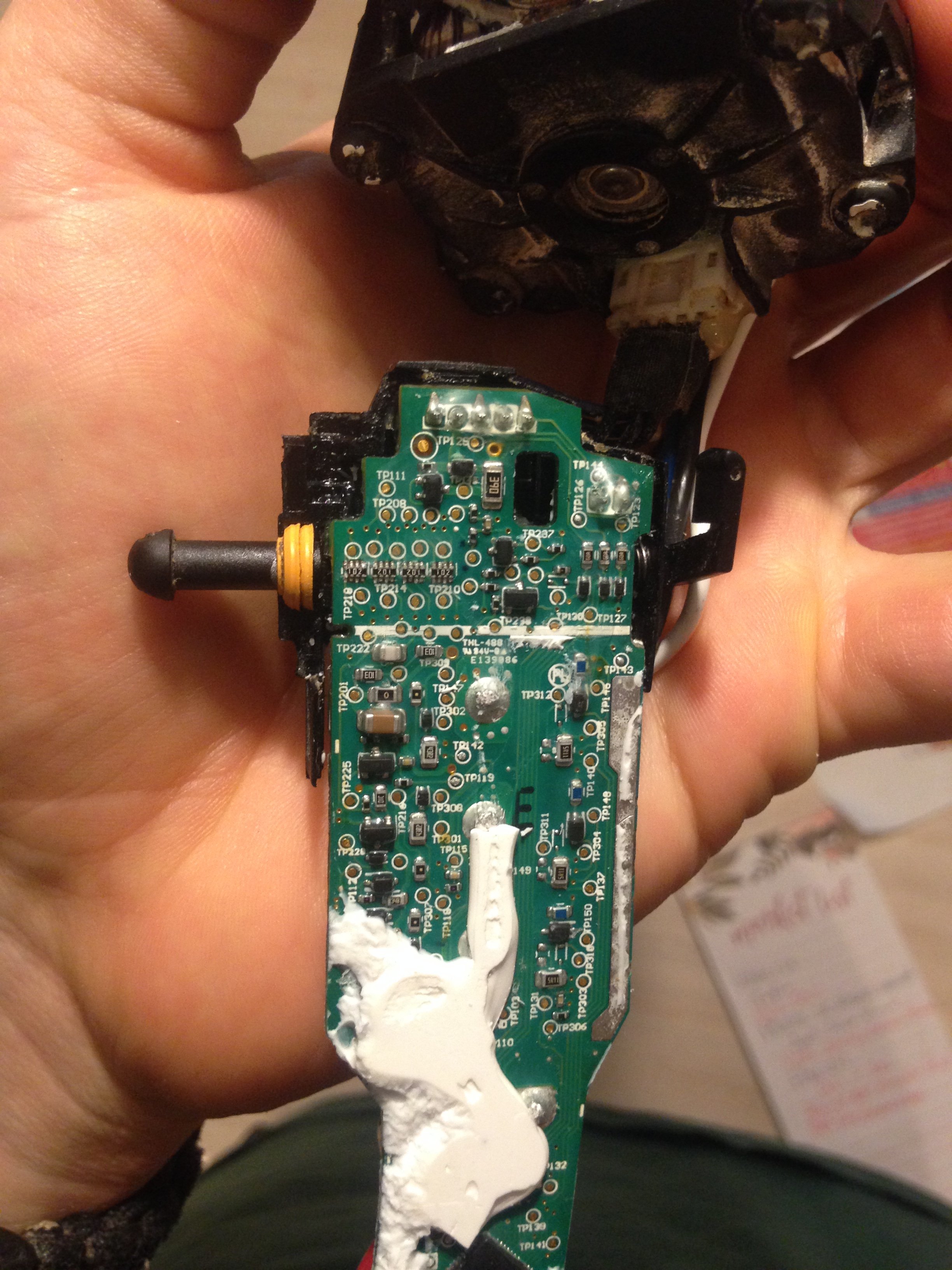

Here is picture of the softer type silicone that was on the board.
There are three types of coatings:
1. Conformal coating
2. Soft flexible silicone
3. Silicone adhesive on backside
Would you consider the softer silicone a potting compound?

i imagine the conformal coating was for worksite grime and moisture. The white silicone for vibration and mounting. The coverage for sealing out moisture is quite high and you want no air pockets where moisture be absorbed, migrate to and condense. The white silicone might not be suitably "conforming" to do this.
no

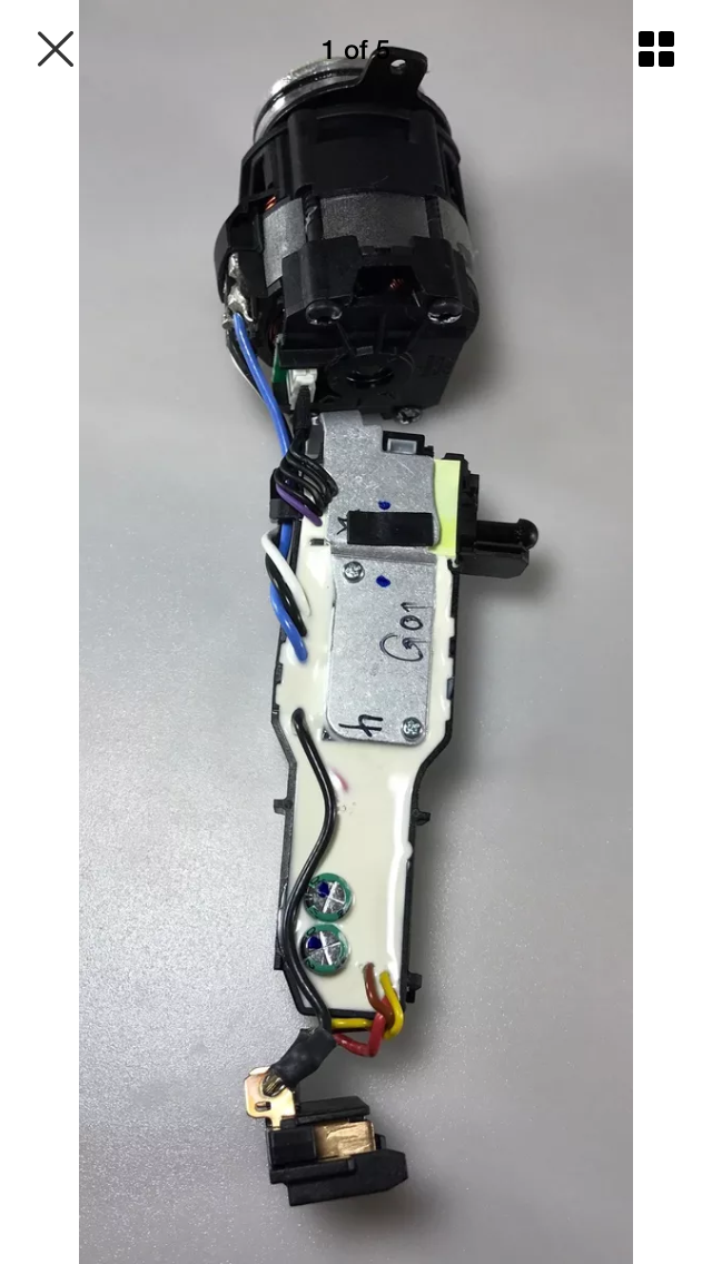

My next question is what would be a replacement for the soft type "potted" silicone that was originally poured on the board. Remember this tool produces a lot of dust and vibration when in use, so I'm trying to get the most amount of shock protection possible.
Or do I even need the "potted" type silicone if I put a couple heavy coats of silicone conformal coating on the board?
