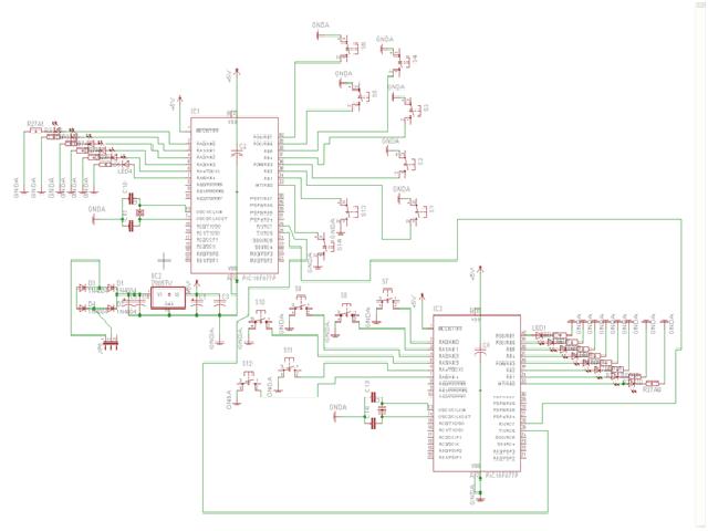

Hi
I will post my schematic for my project and code I use for PIC1 and PIC2. I hope it is visible enough. Only switches, LED, resistors, PICs, power supply and oscillator.
Here is the code for side I call "Transmitter" or PIC1. In the shematic it is upper PIC
Actually both sides are both transmitter and receiver, but I name one side "transmitter" and other "receiver" for no special reason
hi pic2pic.
Downloaded you latest txrpic1 and rxrpic1 programs, I will reply later today after testing.
IMPORTANT:
On your very blurred drawing I dont see any pullup resistor on the PORTA or PORTB switch inputs.???
In one state the input pins are 'floating' open circuit.???
Is the drawing complete.??
The way this schematic works:
The switches I press on side PIC1 is showed on LED on the other PIC2 ,and the other way round, the switches I press on side PIC2 is showed on LED on the other PIC1
Yes, there is no resistors for input. Does it no resistors means HIGH input. I was always considered no resistors as high and it worked

I have two programmed 16F877 pics sending data to each other, using your first program.
It works OK.
but you MUST have a pullup resistor on the switch inputs, a 4.7K or 10K for each switch will be OK.
NOTE:
As a test I have just removed the pull up resistors from my PIC's PORTA....
the mains pick up causes the other PICs PORTB LED's to flash...!!!
Pins left floating can mess up alot. Put pull downs on pins that need to go high. Like add pull down resistors to the pic side of the switch if you are testing for a high. If you are testing for lows then add a pull up to the pic side.
When no pull-up/down are used the pin is floating and almost anything can alter the pin state. Even your hand moving close to the button or pin.
OK I am going to try. I hope that is. :)
On some PICs PORTB they have internal pull ups,[which must be enabled] but there are none on PORTA.
I would recommend that whenever you use a switch use an external pull up or pull down resistor, input pins must not be left open..:)

I can't believe it :)) . It works :)) I had a thought It maybe need pull up resistors, but in my earlier projects it worked with no pull ups, so I consider it not needed.
People thank you all. Really really . You helped me a lot. For weeks I been working on this :)) . Kind of I know the answer, but ...
This can be good advice for beginners :) . Code works, schematic is good except pull up resistors needed.
Ok people see you ...Thanks again :)
