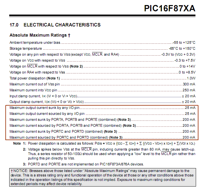

And you think a pic can sink or source 20 to 25ma That is wrong what the data sheet tells you that's the max for one pin
Not a port of pins
In real life it's more like 50ma for the whole port
If you read the data sheet it tells you that the chip can have a combined
usage of 200ma for all ports Pop that by 5 and see what you get or 4 to make you fell better

We seem to be getting our wires crossed.:)
Where does it say on the OP's posts he is running each of the 7 leds at 20mA.??
This blinking problem as I understand also occurs when not all 7 are in use.
I am aware of what the datasheet says regarding the current sink/source.
Refer image.
I am puzzled why you seem to be taking this as personal attack rather than a technical discussion.:confused:
