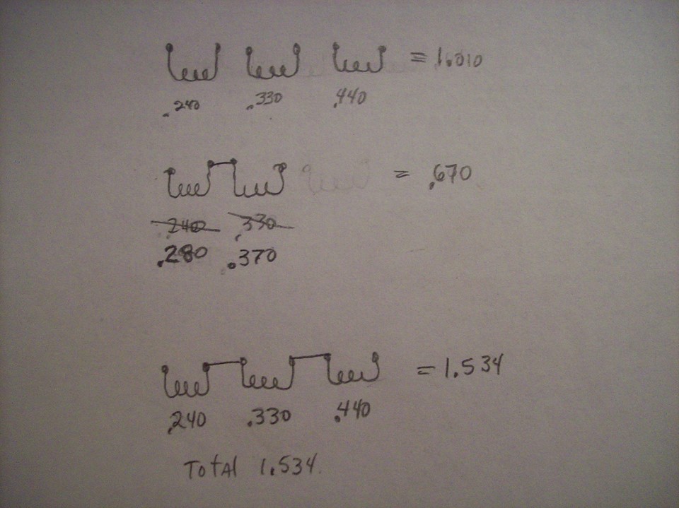

What are these & what can I use it for?
Any way you measure inductance it does not work like this.
If you were tough "mutual inductance"; there is none here.
If you think turns squared; it still does not work like this.
I am certain these are resistance measurements. Resistors add up just like this.
What is the copper strap around the center do?
