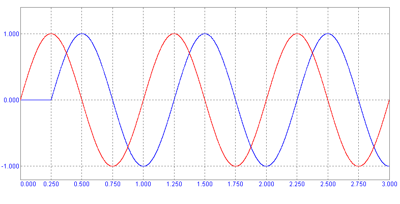

Here's a drawing of a sine wave (red) and a delayed sine wave (blue). Note the blue one is zero for 0.25 seconds because the delay factor for that wave is 0.25.

I think this is in time domain, if we considered i\t freq. or e^-jwt how it will be shown??

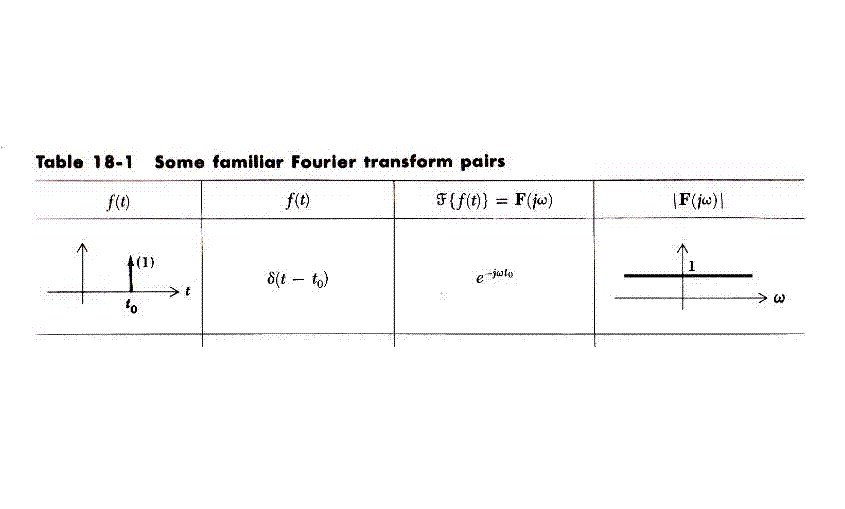

Hi again,
Is this what you wanted to see?

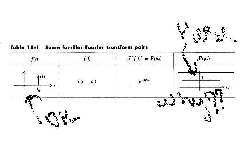

Hello,
Not sure what you are asking. The table came from a book, "Engineering Circuit Analysis".
Its simple as in time domain, the signal is shifted in t sec. ,but-in freq. shifted upward only ,why ??
What do you mean shifted upward?
