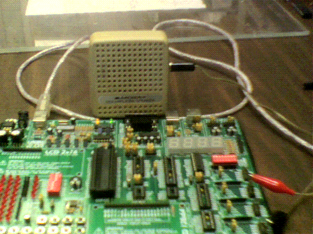

That is all the code. clock speed is 8 mhz. Like I said I used an example program from mikroe and removed 4 extra tones I didn't want. I'm just now trying to get this programmed, so there isn't a schematic. If you're not famalliar the developement board has a pushbutton for every input and a led for every output (when programmed as such) . there is a header to connect to the 'real world' and I've got a amp/speaker connected see attached:
I don't know what the code is supposed to look like (herein lies the problem!).
almost forgot! tried changes and tone cycles on/off every 2 seconds,all by itself

Put JP17 to GND and try the code again if doesnt work try JP17 to VCC and use

Philba: watchdog is off
Atomsoft: tried new code and now it doesn't do a thing. Here is the original code from Mikroe that I modified. Did I do/not do something really stupid?

Make sure its pull up meaning when nothing is pressed its at a logical 1 and when press it jumps to 0v.

Pullup is working (10K) and when button pressed it goes low. Still no tone, I can see I have a lot to learn. The terminology is killing me more than anything. I'll try more in the morning.
