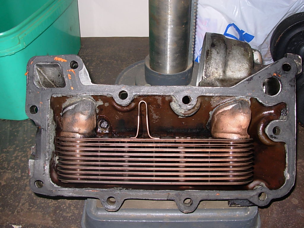

So I went and washed the whole truck, and struggled a bit to remove the oil cooler. Heck but those engineers chosen the most awkward place for it.
Then had to clean it at well, very messy job.
It cost my some tremendous sunburn to the forhead and neck area, a complete sore boddy, very sore feet for some reason, and black arms.
Darm, how do you get this freeking oil off, five different types of soap and a nail brush, and the only places where the oil is off, is where my skin came off.
Any case, here are some photos.

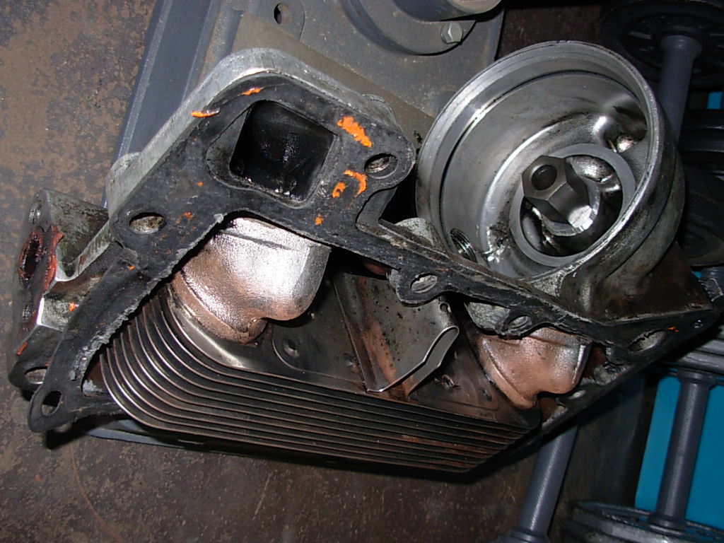

The oil enters and exits the cooler via those two brass looking pipes, and the block via the two holes at the top, one in each corner. To the rear of the cooler sits the oil filter assembly, the big round part for those not to sure.
So the oil pass through the part with the fins, while the water surrounds that.
One interesting thing I've noticed, there is only one entrance/exit for the water. the other possible one was blocked off. So this oil cooler is not a oil cooler, how can the hot water circulate?
On the second photo one can see where the water pipe connects, to the left bottom part of the casing.
The casing was also severely pitted at some places, the grey areas in the first picture.
But guess what other observation I have made?

arrie,
there are indeed two connections for the oil circuit and two connections for the coolant circuit:
The first pic shows both of the oil circuit connections...top left and top right, connected together via the filter housing.
The second pic shows one of the coolant connections at the lower left. The other connection is where the whole cooler assembly attaches to the block.
Now, being familiar with how a system is ideally supposed to work, and having to work with what changes an engineer has made to suit his/her requirements are two very different things. Kinda like the electronics industry too.
After looking at your pics and noting how the kind engineers have made life difficult, there is no bypass available since you have no exclusive access to either circuit. Unless you can bench-test the cooling unit with the filter installed, you are at the mercy of replacing the complete unit and re-testing once installed, or making a blanking plate which blocks off the coolant side of things but leaves the top two passages of the oil circuit intact.

It actually dawned on me this morning that the 'other' water connection is the block.
My other observation is that the device is not damaged to the point where it could have resulted in such an catastrophic failure.
I'm on my way to merc commercial vehicle now to see them about the problem, but I probably have a head or head gasket problem.

If there is no obvious visible leak on the cooler, refit the oil filter and plug up one of the oil lines then fill the oil circuit with parafin, or something similarly thin. If you can pressurise it, even better, as there could be a small crack which only opens under pressure from the oil pump.
Rule out the less expensive jobs first...

I have handed in the oil cooler for testing today, will probably have the results tomorrow, but I suspect that the casing will need replacing, there are to much corrosion around the area where the cooling fins attach to the housing.
