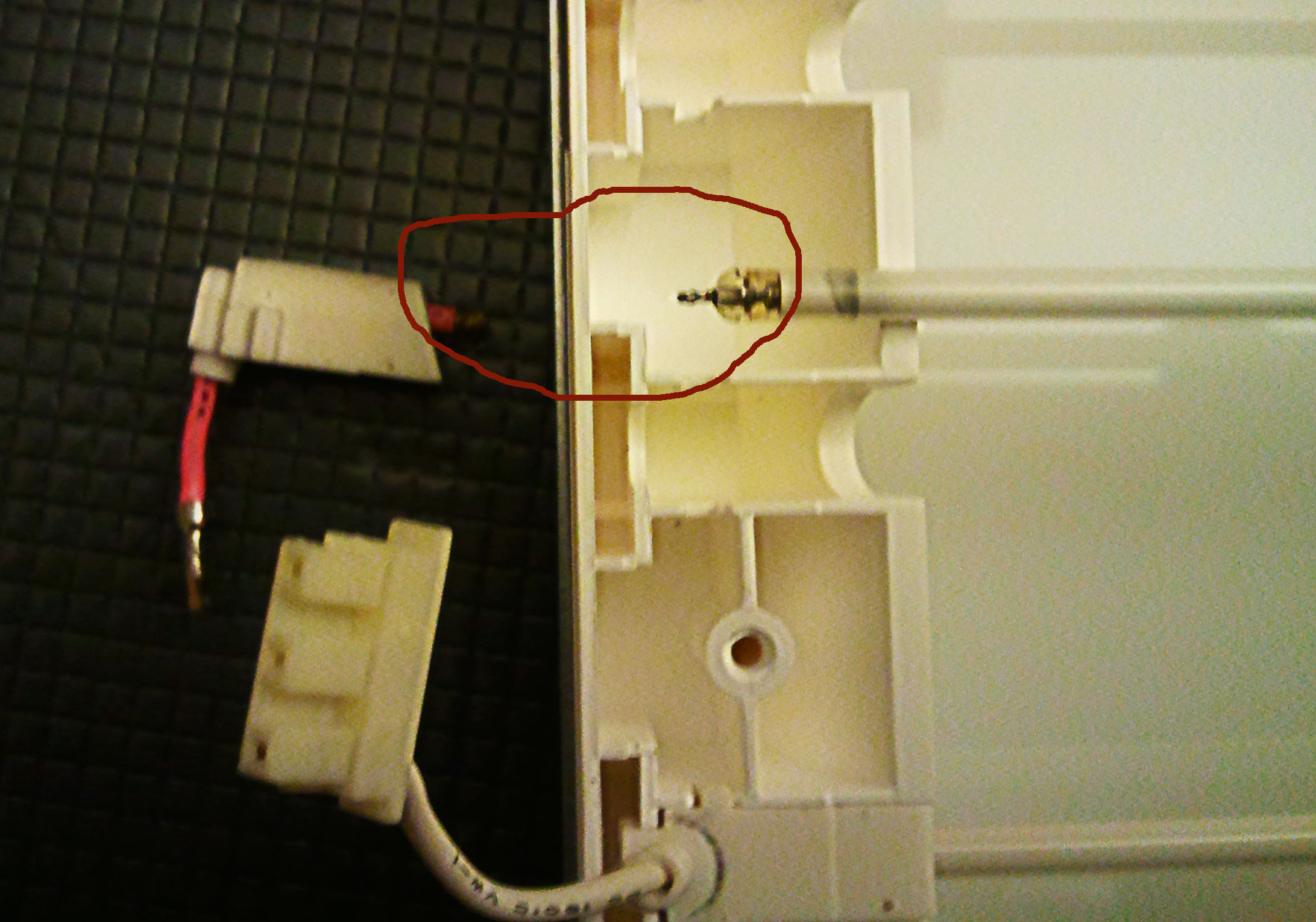

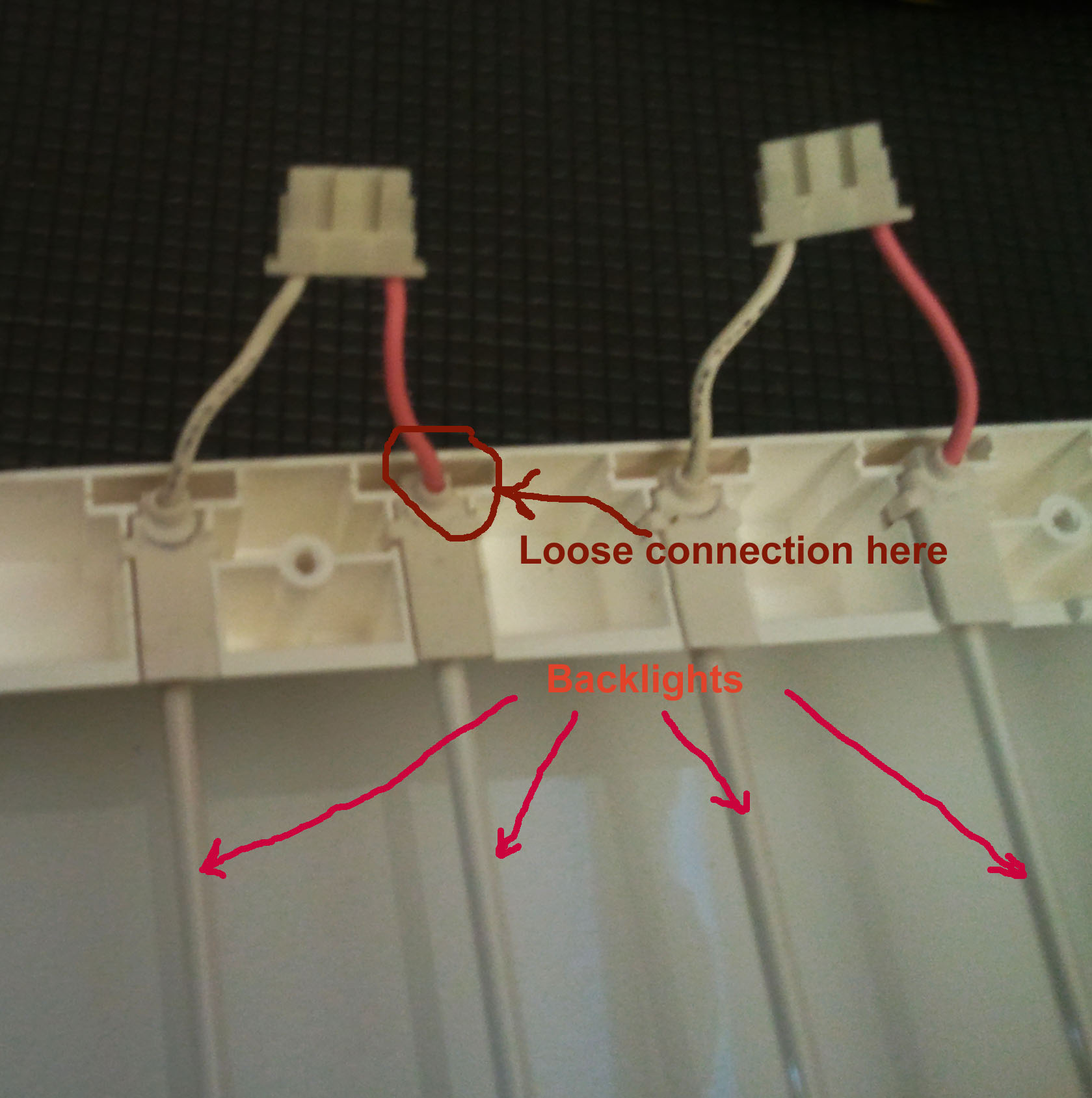

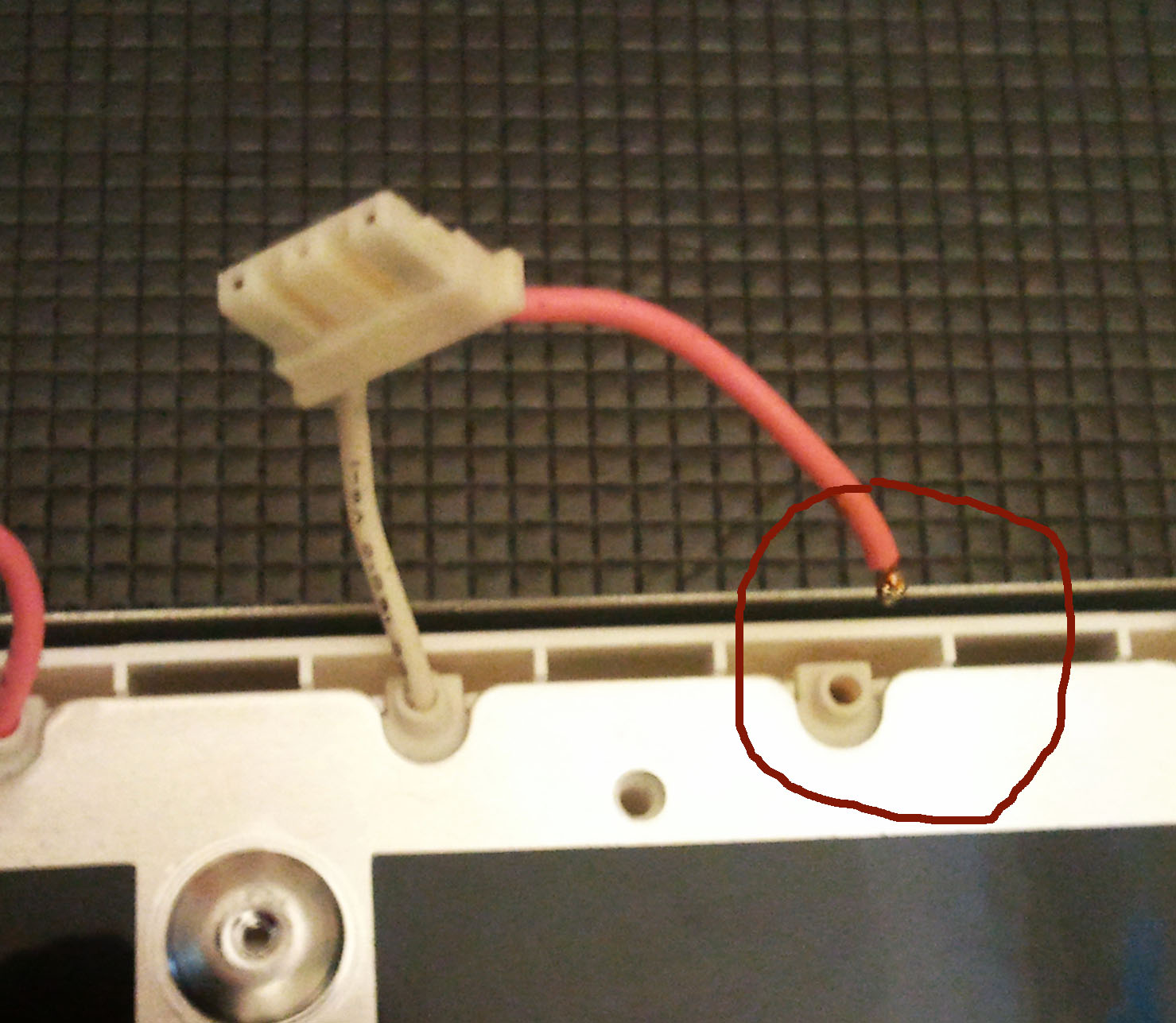

I have a Westinghouse LCD TV model LTV27 w2 and the backlight goes off all of a sudden after a few minutes. Sometimes it stays on for a few minutes and sometimes more than 30 minutes. The backlight stays forever after I turn off then turn on the unit but sometimes it takes several turning on and off for the backlight to get steady on.
Has anybody have any idea what's the cause and how it could possibly be fixed?

I disassembled the LCD assembly and resoldered the loose backlight connector which causes the display to go off after a few minutes.
