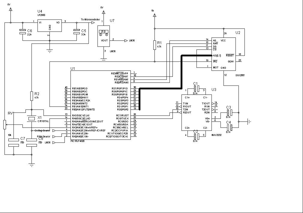

@ Kchriste here is the schematic.

Syed,
Why are you running the PIC on 3.3V and everything else on 5V?
R2 in your diagram doesn't make sense to me.
Is MCLR enabled in software? If so, you need a pullup resistor on it too.
CS & MOT on the DS12887 should both be tied to ground. The way you've done it will work due to the built in pulldown on MOT, but tying both to ground would be more conventional.
As mentioned by Mike, if you intend to operate the PIC of 3.3V and the DS12887 from 5V, then R1 should be pulling up to 3.3V and not 5V.

About the schematic, i uploaded an incorrect one(sorry) R2 is not present. The PIC is running on 3.3V so that my project can be upgraded. Will heed to your and Mikes advice on the 3.3V pullup. Both MOT and CS are tied to ground.
The problem with doing that is that a 5V part driving a 3.3V powered PIC could cause the internal diodes (from the IO pin to Vdd) of the PIC to conduct, leading to all sorts of strange behavior.
But if i do the 3.3V pull up thing then can i avoid it?
Both the MAX3232 and the DS12887 will output over 3.3V on their IO pins at some point in time. This extra voltage will be clamped by the intrinsic diode to Vdd on the PIC's IO pins (PORTD). Sometimes this will be a problem.
