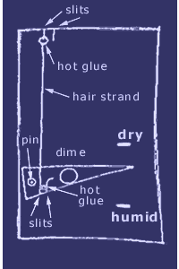

Human hair hygrometer
Harvey would not want to use this but others may find the hair hygrometer of interest.
Hair changes length depending on humidity. On more humid days, hair will lengthen.
The diagram below shows a simple hair hygrometer. It takes about a foot of hair to create a sensor but it could be wound around a pulley or two to decrease the length. The pointer could be used to block light between a LED and a photo transistor for sensing.
Image .
EDIT: Horse hair can also be used and may be more durable.
Image .
I saw something like that when I search for weather related science fair projects. Figured it wouldn't last more then a few days or weeks. My hair is llong enough, fairly strong. My thought was to hook the hair to a light spring, and use the spring for the coil in an oscillator. Stretching the coil should change the frequency. Figured It would be very subtle, an kind of involved getting into a microcontroller. Would be nice to find a cheaper humidity sensor for this project. The one I ordered is $9.90, about twice any other part in the project, so still keeping my eyes open for alternate sensors. Mostly, I want to get something thrown together, just to see if this idea was any good, then work on making it simpler and cheaper. I don't think I get away with just making one or two if it works out.
