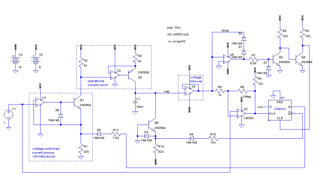

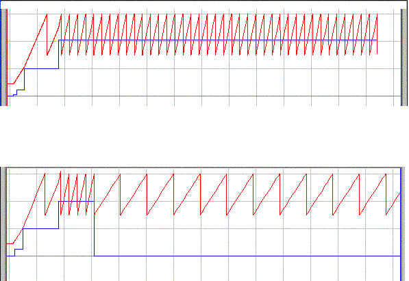

I fed into your VCO the following input (graph), deriving the output depicted.
This made me realise that the capacitor charges and then discharges due to short circuit by the 555 time (threshold exceeded etc etc).
The discharge capacitor then starts to recharge until threshold is reached again and will be discharge and then will start to charge again and SO ON.
(Right?)
This means I understood the VCO's operation.
But, I noticed that the output continues to exist even when the input reverts to zero, so i figured what if I can suggest ways to stop that?
(It will be like a "one-shot" sawtooth generator.)
When I ran the sim with zero volts on the input, the ramp output rose exponentially to 1.9V. I think the results of a sim will depend on the models you use, and actual hardware will behave somewhat differently.
So what do you actually want to do?

Oh,yes I noticed that difference.In my sim, the cap is charging linear.
What could likely occur in real case?
Maybe the first peak in my sim was as much as all the others.Yeap, it was, i think.

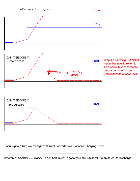

I just want to know if there is a potential for a schematic that does what the graph shows :?
In summary, various input voltages (pulse-shaped) are entered into a V-I converter, which charges a capacitor linear.
Then when the voltage across the capacitor tries to exceed the input voltage, a circuit component (DA, or 555, or dual slope integrator :?: )
"clamps" both input and output to zero; so that the system can except a signal at its initial input again. :shock:
At least let me know how much impossible that is. 8)

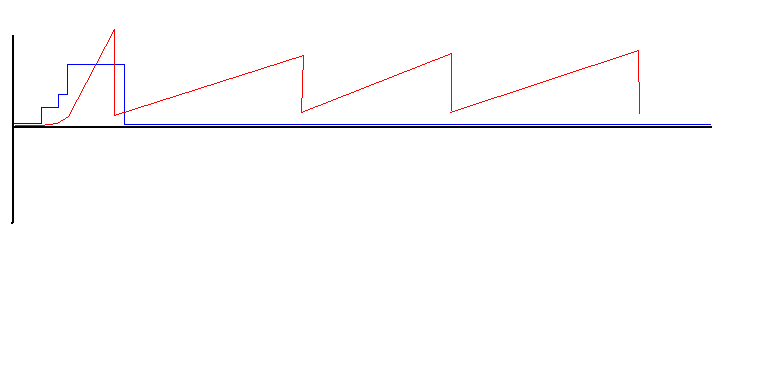

Hi, I am back! (A lot of study for the past two days) :?
Ok, here is a graph from my sim when I feed the input into the VCO.
As you can see, no input works as what I think we can come up with. :cry:

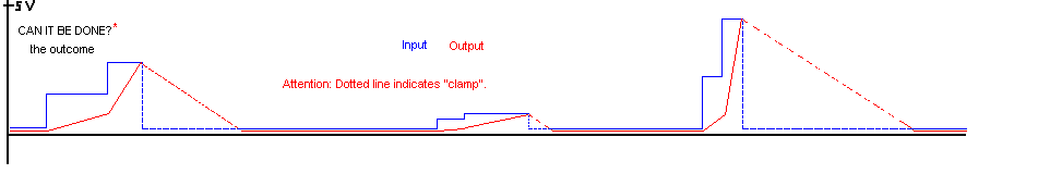

See this graph.
It is the output I want to have as time evolves and as input voltages change in level as well as when "time of voltage level change" changes. 8)

The trouble with the dual slope integrator is that, IMHO, you dont have time to do it. It requires counters and logic (or something like a PIC) to implement it. And an op amp integrator is a MUCH better way to do it. See **broken link removed**.
Regarding your last post - If you clamp the input voltage to zero, what is going to cause that clamp to be released? Are you going to do it with a mechanical (pushbutton) switch, or does it release after a fixed period of time, or... :?:

As the graph indicates, the clamp-release occures after "change of condition between in/out voltage levels".
You can see that the clamp condition starts when the output (capacitor voltage) gets greater than input voltage.
The clampl of both in/out occurs until the point where the output becomes less than the input.
Of course, that operation requires the input voltage to be clamped much more drastically than the output 8)
Is that possible? :roll:

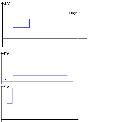

Oh, let me see if I got your question :?
The input signal I designed in the graph we can assume to occur due to another signal before it.
Meaning, that dc voltage variation could come from a signal before it that has a fixed time of occurence (this is why I reffered to the system as "one-shot"); let's say 15ms.
For example, it may be an analog sine wave. :shock:
The sine wave could have different peak levels that are converted into relative DC signals (not same levels' conversion-just relative; But I don't know if that is possible :oops: ).
So, the real problem would be that the DC converted signal has infinite time of occurence, while the signal before it has a finite time (15ms).
In addition, a second finite sine wave can occur only after 30ms from the first (we set this as a "rule of thump", cause it simplifies the way the clamp could be released).
Considering all the above, I think the simplest (if not the only) way to go is by setting a fixed time period for the external stimulus to reset the clamp.
Assuming the input signal takes its maximum level in no more than 15ms, then the capacitor discharges around the 25th millisecond. :idea:
So, the input can be stopped to be clamped after the 26st millisecond 8)

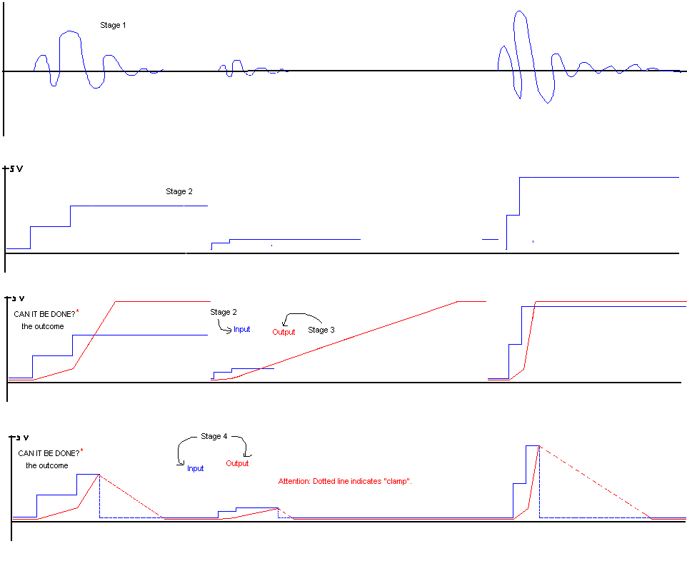

Ron H, I have given som thought and made it pretty straightforward.
Here is a graph with all the stages.
The stages are:
1. An- of "random occurence"/"random voltage level" Signal (Any kind of random sine or triangle wave, i.e a sound)
2. The signal is fed into a circuit that transforms its "corners" into DC levels.
(Unfortunately I don't know how to do that :oops: Maybe it can be done with some kind of rectification :roll: )
3. The DC level signal goes into a V-I converter that charges a capacitor linearly.
NOW, the problem here is that due to the step 2 process, the first input greats a DC voltage output that lasts FOREVER (Remember that!)
The next input cannot be inserted unless there is some kind of "input disconnect" from the circuit.
The same applies for the linear charging capacitor!
The cap charges up to the V-I operational point.
The system looses a vital info about the differences of maximum voltage level between different inputs in stage 1 :roll:
4. The linear charging capacitor is discharged when the dc voltage (input to the V-I) is equal with the voltage across the cap.
In addition, the DC voltage (input) is also clamped to zero as long as the (decreasing) cap voltage is greater than the clamped DC;
OR
for a fixed time set by us, preferably 25-30ms after the time point where the voltage clamp started. 8)
Here is the graph.
Thanks for helping out :lol:

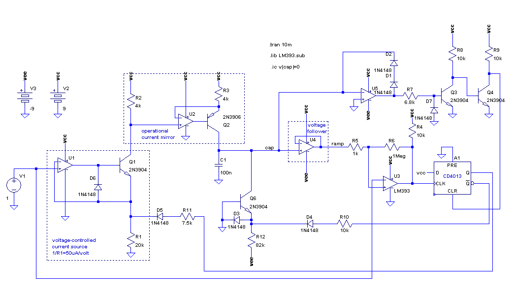

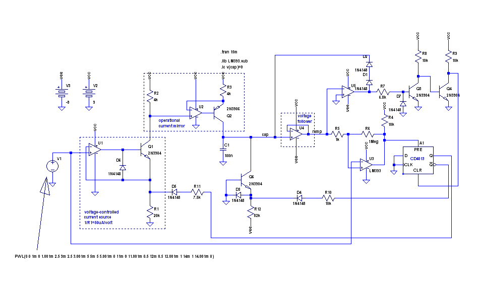

See if this will work for you. It works in simulation with a DC control voltage. I had to set an initial condition for the voltage on the ramp cap (.IC v(cap)=0). Otherwise, it didn't run as a VCO.
The input voltage isn't clamped. Instead, I cut off the current in the first VCCS (R11, D5, D6). It should work better than a clamp.
See if you can figure out how it all works.
My problem is, this has gotten so complex that it is no longer trivial. I actually have to spend time designing, and I'm pressed for time.

Considering you have designed a schematic, may I put you into trouble in asking you to declare a LITTLE general theory into the schematic?
You see, I have been trying today to simulate it, I haven't been able to do so, I am afraid :roll:
The signal I am getting across the cap is linear, greater slope for greater voltage, but the cap does not discharge (in my sim) :(
I understood the parts that are described on the schematic (those included in dotted boxes), however I cannot manage to comprehent the other parts.
For instance, I read about flip-flops too, but I could not see how that helps for the capacitor to discharge and for the initial input to be "disconnected" from the circuit.
A block diagram with all the steps/stages and a title for its stage is all I am asking, I think :roll:
And if it is easy, could you please put into your simulation the 3 different inputs depicted in the graph below?
I think the best way for me to understand if the circuit does what I thought it could do is to see the in/out graphs.

Well, I think you have helped in forming me into a better circuit designer :!: (if I am at all that :oops: )
I made one error in the schematic. It works as I drew it, but I'm posting a new schematic with the inverting input of U5 connected to C1 instead of ramp, which is the buffered output. It will be easier to describe the operation with this change.
I also realized that it would probably be better to connect the output of U3 to the PRESET input of A1, and tie the CLK input to GND. This should prevent the potential lockup condition which can occur, at least in the sim, and maybe in hardware. I solved it in the sim by setting .IC v(cap)=0. I didn't make this change on the new schematic.
I can't sim this now, because the file is in my computer at work, and I'm at home. I'll try to describe how it works.
You already know how the VCCS, the current mirror and the voltage follower work.
Q6 and R12, when Q6 is on (it is initially off), provide the current sink which will discharge C1 linearly. U3 is a comparator that senses when the ramp exceeds the control voltage. When this occurs, U3's output rises abruptly (guaranteed by the slight amount of positive feedback through R6), clocking a logic "1" (vcc on the D input) into A1 and causing A1Q to go high (vcc) and Q/ to go low (0V). This forces about a milliamp through D5 and D6, cutting off Q1, which in turn shuts off the current into C1 (this is equivalent to clamping the control voltage to zero, but is easier). At the same time, current ceases to flow through D3 and D4 (Q/ had been high and is now low), so Q6 turns on, discharging C1 with a current of about (9-0.7)/82k=100uA. C1 voltage slopes in a negative direction until U5 senses that it has gotten to GND (which is on the + input pin). When this happens, U5 output goes positive by 2 diode drops (approx +1.2V), clamping C1 to zero volts by diverting the discharge current, which was flowing through C1, through D1 and D2. With 1.2V on the U5 output, Q3 turns on, which turns off Q4. This applies vcc to the CLR input to A1, causing the outputs to switch states. This turns off the discharge current sink Q6 and simultaneously enables Q1 once again (by cutting off D5). If a non-zero control voltage is present, C1 will begin to charge again. If the control voltage has gone to zero (as you showed in a previous post), C1 will float, and may slowly charge due to U1 and U2 offset voltages and U4 input bias current (it can't discharge further, because U5 prevents it). Floating is not desirable, but it is one of the scenarios you proposed.
I hope this makes sense. I'm gonna be out of town for the rest of the week, starting around noon tomorrow.

Nice theory explanation. 8)
The only thing I did not quite get is the "floating" thing at the end :roll:
I am a little concerned about the "non-control voltage" state. :?:
That thing about the slow charge of the capacitor. :?
I think it should not be there :roll: Can you explain a little bit?
Last but not least, would you mind putting the different control voltages into your sim, at some point of time before you leave?
It would be vital to have in/out graphs of a "working circuit"; since I did not manage to make mine work and yours is, what about you simulating it?

I changed the connection from U3 output to A1 PRE, as discussed above. I ran the sim for two different input scenarios, as shown. If you need more, you'll have to figure out how to run the sim.
With zero control voltage, the ramp actually oscillates between ~+18mV and -18mV (this occurs during the time I predicted the "float". I was wrong. :( ). The control loop tries to keep it at zero, but propagation delay around the control loop makes it oscillate. This could be minimized by using faster transistors (Q3 and Q4), faster op amps (U4 and U5), a faster comparator (U3), and a faster flip-flop (A1). Using a faster Q6 would be of little help, because it doesn't saturate (no storage time).
Various other schemes could be devised to speed up the loop, but I think it is impossible to totally eliminate the oscillation, due to the digital device (A1) in the loop.
I think the oscillation is too little to cause trouble. :?
