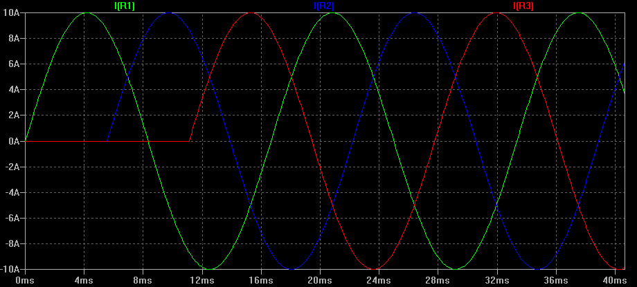

What will be the waveform of the phase currents of 3 phase synchronous motor, if the stator winding are 120 degree apart. I hope it should always be sine waves with 120 degrees apart. Am I correct? Please advise
Yes, the below is an example of 60 Hz. Three Phase.
The currents are IR1 Green, IR2 Blue and IR3 Red. The peak currents are 10 Amps in the example.

In the above illustration IR1, leads IR2 leads IR3. The phases are 120 degrees apart. If I reverse two phases I get this:
Note the phase rotation change.
Anyway PWM and H-Bridge are not used for any control of an AC motor.
