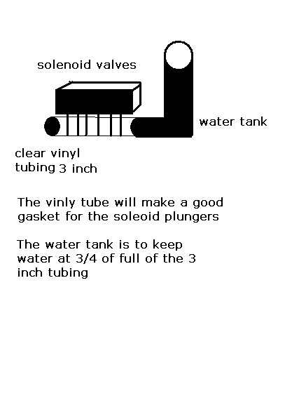

This is my idea
Sounds similar to my concept. Therefore I agree....

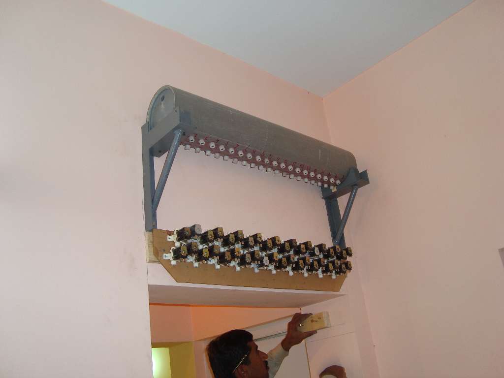

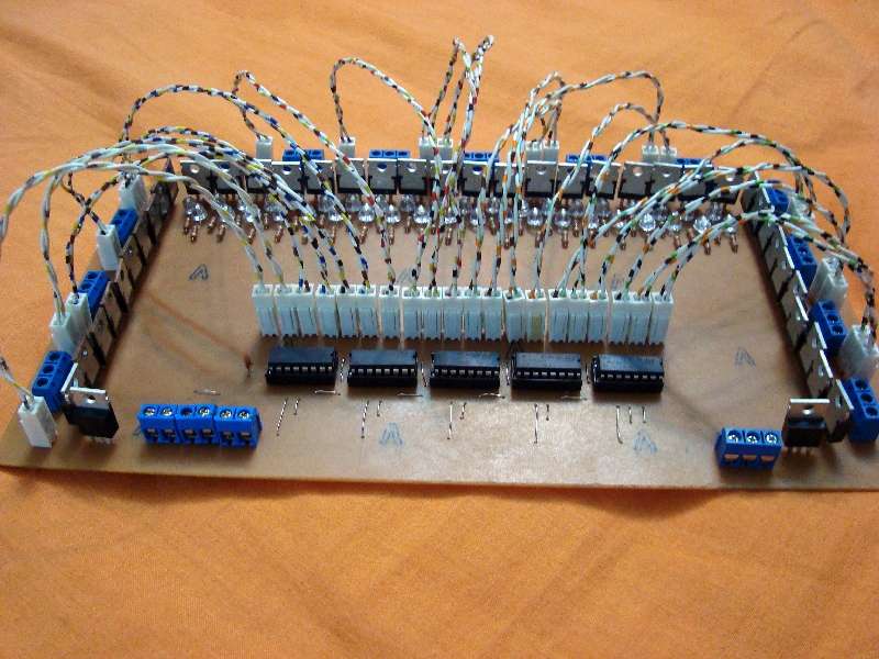

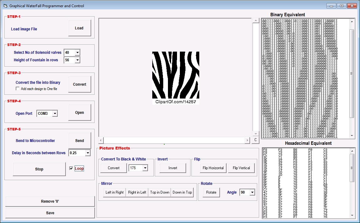

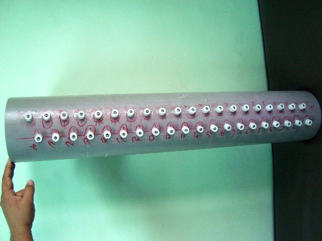

I have almost completed the waterfall with 40 Solenoid valves ,the Simulator, electronics and a graphical software to generate the bytes from pictures and send to the microcontroller.
Will soon post the details.
Regards

That looks pretty good. Can you share the Gui software to xmit the gfx to the PIC with us? I guess it's a serial out?

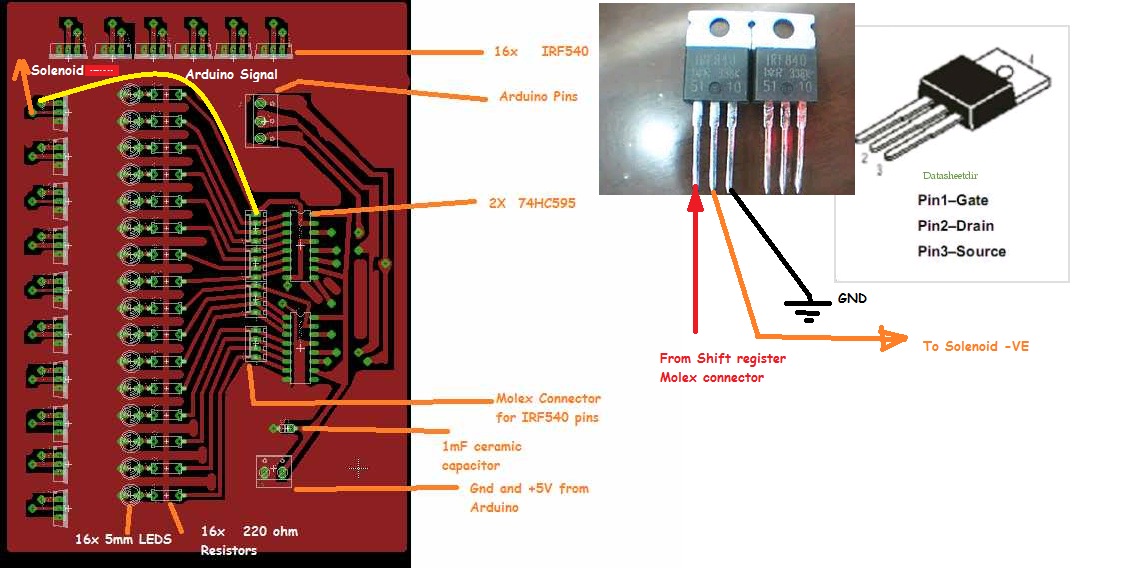

The Software send the bytes to the Arduino through USB which then send 5-bytes(40 bits) to Qty:5Ea 74HC595 shift registers. I am using IRF540 to control the solenoids.
The Software is working perfect and at 9600 baud i am having no loss of data. Attached is the file that is generated by my software for various designs for 40 solenoid valves (5-bytes per row).the file can be open in any text editor i.e. Wordpad or MSword and Select the font TERMINAL and font size =8 for best view. i am fine tuning the software and will consider sharing it later.

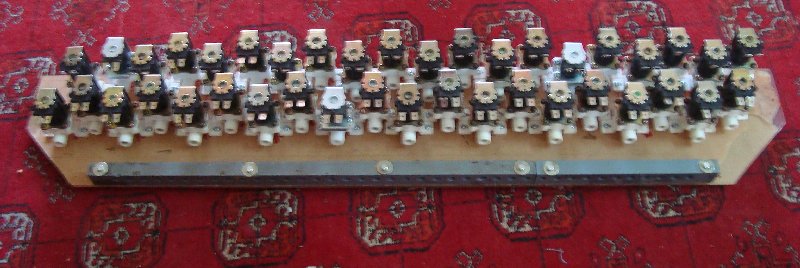

Yesterday the installation of Header and solenoid was carried out. Now wiring the solenoid will take time, hope i will be able to test the complete system by the weekend.
To all electronics GURUS , How can we increase the Solenoid response time electronically? So that i can Quickly ON/OFF solenoids...

What is the spec on the solenoids u have? As far as I have seen 20 to 40ms is the best u can hope for.
If u parallel solenoids and add another output routine to your code u can halve the response times. But at around $10 to 15 for a solenoid it get's pricey doubling up on those. Also adds more chance of a solenoid failure.
