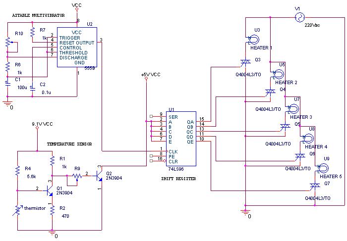

water heater with temperature controller
i don't think ur design is correct.
read the above proposed idea once gain.
the shift register should shift only when the counter overflows , and that is when the temp has not reached the desired level until 'N' pulses of 555 . If the temp has reached further counting of the counter should be inhibited (inhibition signal to 555 or to the counter itself )
The thermistor would have to be able to trigger and/or reset the 555, what happens if the temp is reached during the count.
My idea is when the desired temperature is reached, transistor Q2 will turn on and the current supplying the counter will go to ground thus basically turning the counter off.....Based on what I designed, am I right or not???
I have changed my design....
The idea is this.... the potentiometer R9 will set the desired temperature by limiting the current that will turn on the transistor Q2. The 555 timer, set at long intervals, will clock the shift register which will turn the heaters on.
Once the temperature is reached, transistor Q2 turns on and the voltage that supply the shift register will go to ground thus basically turning it off.
Pls. comment on the design.
Did I wire the shift register correct???? How do I wire it correctly??
Don't forget to reset the shift register once the temp has been reached, or the next time there will be X + 1 burners come on instead of one burner
