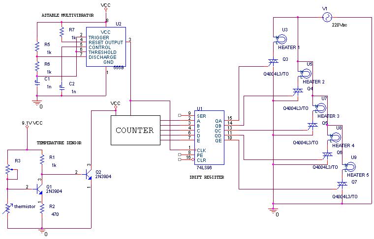

My instructor ask me to build a water heater for our school project. The circuit should trigger up to 5 heaters depending on the preset temperature. The idea goes like this....
The first heater will turn on.... if the temperature doesn't reach the required temperature, the second heater will turn on also so that there will be 2 heaters turned on. But if the required temperature was reached by the first heater, the remaining heaters will not turn on.
I've already constructed the AC part of the circuit which will turn the heater on.... my problem is the circuit that will trigger it.
I was told to use a counter, a shift register, a 555 timer, and a thermistor.
Can anyone help me please????

I'm not allowed to use a uC, just the parts I mentioned.
I already have the temperature to voltage conversion circuit which uses a thermistor in a voltage divider configuration and will trigger an NPN transistor. The rest of the circuit, as ThermalRunaway says, will be my problem. But I hope that you can guide an electronics neo until the project is finished.

I can't find a 5-bit counter that will be the input of the shift register. And also does the clock input of the shift register should come from the output of the 555 timer just like what I did?
I've made all the circuit except for the counter and I want to post it for your comments but I can't figure out how.....

Ok so I assume the rest of your project is working as you'd like, but you haven't decided on how to build a 5-bit counter, right?
Firstly, I don't quite see where the counter fits into your design, and I don't see how the counter would be an input to the shift register either, but to answer the question you actually asked, there are a couple of ways to build a 5-bit counter.
The way I'd do it is to buy an 8-bit counter IC and set it up to reset once it had counted to the number I wanted. In your case, a counter which resets at 31(decimal) 11111(binary) would give you a 5-bit counter.
Another way to do it is to actually make the counter yourself out of D-type flip-flops, then you can build any type of counter you like!
Regarding the Shift register you can clock it off anything you like, provided you're using TTL logic levels and you don't try to clock it faster than the device can handle. In your case, you only want to clock the shift register when the output from your comparator circuit is saying that the water isn't hot enough, AND the 555-timer time_duration has expired. So you're clocking the shift register via the output of an AND gate which has the 555 timer and your comparator circuit as inputs to it.
You mean my design is wrong.....can you pls comment on the attached image..
