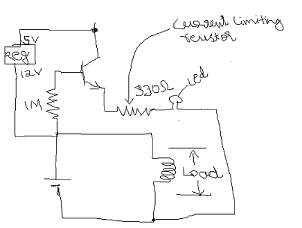

I was just thinking weather we could do this.
In th eschematic i have attached, The 1M resistor will not supply enough current to drive the transistor. THis will be the case when the bulb is working.
If the bulb fails, then then more current is through the 1M resistor. THis will be enough to drive the transistor. which will turn on the LED.
Can we do this??

No, that won't work. The battery voltage is (nearly) independent of whether the bulb filament is intact or not.
