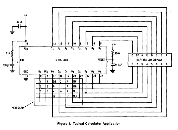

That chip does look much better, Im trying to work out if this is designed to use with a multiplexed segment display or not.
If not, then i guess it would be pretty simple to use with nixie tubes, although i would need to use 9x 74141 chips (one for each nixie) if i dont multiplex them.
One question, i dont see any output pins for the decimal points. My nixies have decimal indicators on them, so how are the decimals handled?
You can take another BCD to decimal decoder and use that to operate the decimal. Only one it lit at a time usually. e.g. 00 is this decimal 111. and 01 is this "11.1" one etc.
One question, I don't see any output pins for the decimal points. My nixies have decimal indicators on them, so how are the decimals handled?
As shown in the schematic below, from the National MM57459N calculator chip data sheet, the output to the display is multiplexed and includes a decimal point (DP). The output encoding is for a National NSA1188 7 segment 8 character LED display. **broken link removed**

As far as using 74141 chips, these are not designed for a multiplexed BCD signal, so i could not connect these directly to the output of the NSA11887 as far as im aware?
Although 74141s were not designed for multiplexed displays I think they would switch fast enough to work. You would need transistors (A PNP one with it's emitter connected to the positive high voltage supply driven by an NPN transistor.) to provide digit select to the nixie anodes. Another solution would be to demultiplex the signals using a 4 bit latch driving it's own 74141. The data inputs od all the latches woyld be in parallel and they would be cloached with the digit select signals.
