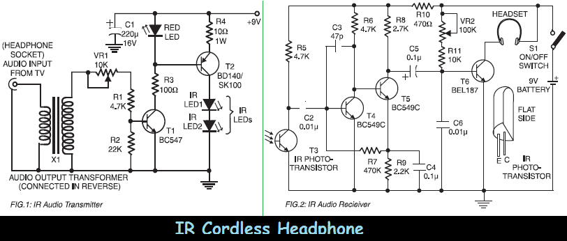

I am new here and I would like to know how to to make wireless earbuds. Is there a way to change normail earbuds(phone earbuds) into wireless earbuds?
I think all you really need is to get radio transmitter/receiver right?
Please help me.

Radio tran/receiver like AM and FM can be use but will pretty clumsy with circuit like superhet type. Other type are simple but hard to tuning and big (antenna...). Audio quality also be limited by transmit and receive method.
I have another idea. Infra-red! They are limited by direction, place because they almost like normal light (of course they are invisble). They have advantage are harmless, easy to transmit and pick-up.

No, not hard, much more simple than any RF circuit (except spark gap transmitter and crystal detectorThank you for your opinion. It is very eye-opening, since I didn't know BlueTooth can do that much harm to people. Can you tell me about infra-red edition? is it hard to build? what is it's purpouse?

No, not hard, much more simple than any RF circuit (except spark gap transmitter and crystal detector). Do you already know about photo-transistor? What I want mention here is IR photo-transistors, they are somethings may look like this:
If you don't want to buy, you can extract from IR controlled-car or helicopter (type without antenna in the top):

I have not made yet, I am not very much interested in wireless applications. My headphone still "wire-full"hmm can you show me a picture of a final product?
I have not made yet, I am not very much interested in wireless applications. My headphone still "wire-full". But look at the schematic, I think it will work well but YOU NEED TO MAKE THE EARBUD's RECEIVER FACE TO TO FACE WITH THE TRANSMITTER WITHIN 5M TO MAKE SURE YOU CAN CONTINUE TO HEAR SOUNDS.

The receiver might smaller than a match box without battery. The receiver board may larger than matchbox a little before add 9V battery. I don't expect it will small enough to intergrate with the earbud but at least it is "pocket" like old type mobile phone.Ohh well, I am still wired myself too. I just want to learn to build such gadgets? I don't know the right expression... How big do you think is this things when finished? And this is very hard project for me, don't know if I will be able to do it.
