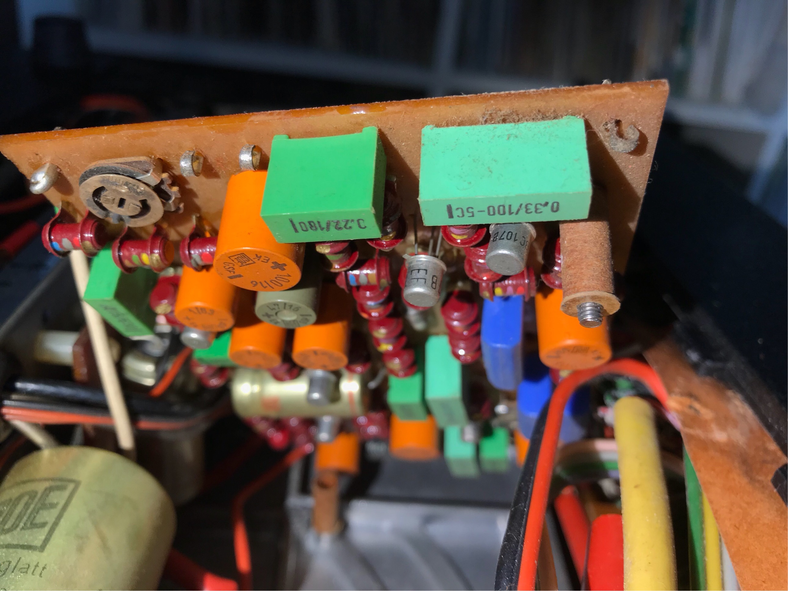

VU meter not working. Dynacord Echocord Super 76

Old owner replaced power caps.
Someone said I could do more damage changing them if I made something wrong. But if just polarity goes correct it should not be a big deal? Suggestions on quality caps?
Panasonic has some very high quality, audio grade caps.
United Chemicon produces some very good products..
For electro caps, polarity, capacitance and rated voltage are the important parameters to be aware of.

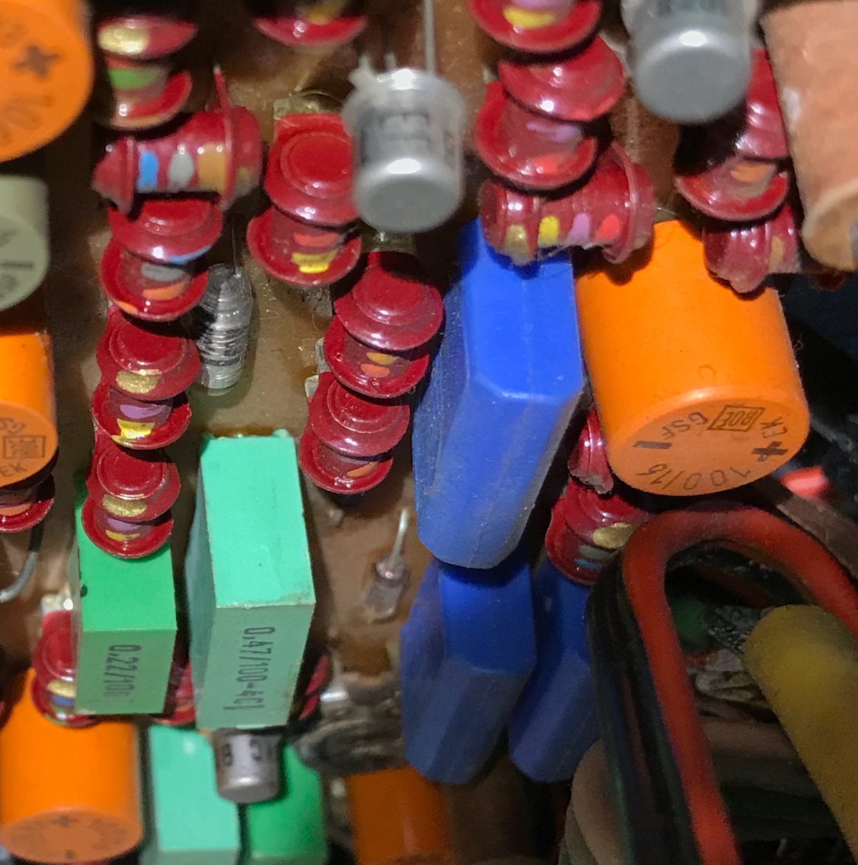

The greens are probably plastic film type (non-electrolytic) and ok to leave. Don't know about the blues. They look asymmetrical on top, which may indicate they're polarised.
Thanks!
Here is a better image on the blue ones.
Can not see any written values on them from this angle.
