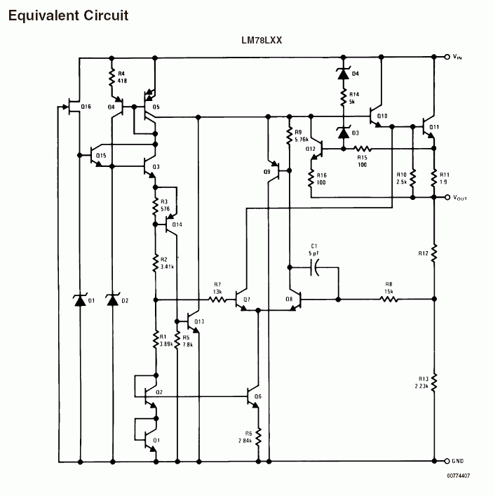

The reason I am posting this question is because my boss saw this zener circuit and said that zener-resistor based regulators are crude, cheap, and they wont handle situations where the AC voltage drops to 100VAC.
For some reason, I used to think that inside the LM7805 there is a Zener!
Just the opposite. The voltage out vs load current of an IC regulator is much flatter than a series resistor-shunt zener regulator.
That's why I said IC regulator delivers more current.
You are right. I meant 4733A.
Slightly more than a Zener.

A Zener is a shunt regulator and is very crude for use as a regulator of voltage if you have to supply current to a load. The 7805 is far superior in general..... which is why they were invented and then replaced zener shunt regulators on nearly everything on earth. Zeners have very limited use these days. There are IC shunt regulators that are far superior and very cheap like the LM-385 for example. The voltage precision is better as well as temp stability.
There might be some Zeners somewhere in there, but only used to set up an internal voltage reference not the output voltage. That is set by a bandgap reference.
