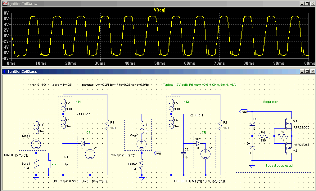

I've been having a play with simulations of (a) a conventional car-type Kettering ignition system with the points in series with the ignition coil primary and (b) the system as per the 98ss diagram. I was surprised to find that (b) gives a higher HT voltage (I think because there's a greater current change when the points short the magneto coil). So the MC manufacturers are right and I was wrong on that score ;).
I've also come up with a possible way of regulating the brake-light voltage, using a couple of FETs. The 'regulator' (shown in the sim circuit below) clamps the voltage when it tries to go above ~6V (adjustable by resistor selection) and simply connects across the brake bulb/switch.

The shunt regulator around the brake light is an option, because when the bulb blows, the regulator would take the place of the 6V drop. You don't have to design it for 10 Amps, just a nominal value of 2.5A. It will only draw the full 2.5 A when the bulb blows. Otherwise it will be doing very little UNLESS you try to make a 6 VAC replacement LED bulb.
alec:
I like your regulator. Seems super simple. A couple of automotive qualified Mosfets & Diodes Really clever.

The .asc files are input to various SPICE programs. You have to have the models. Two popular free SPICE programs are TINA from Texas Instruments and LTSpice from Linear Technology. I'm not sure which one alec is using.
I use LTspice. The Yahoo LTspice User Group has freely downloadable libraries of models.
They would, of course, have to be mounted on heatsinks since they would be dissipating several Watts while the brake is on.
