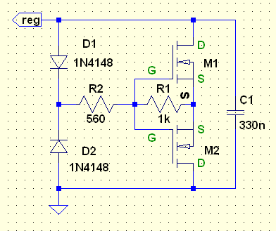

Voltage Regulator for a Small Motorbike, 6V AC Current
to keep the volts up and lights on strong.
'Lights' = brake light only. So far your tests have used DC voltages. The important voltage across the bulb, when driven with AC, is the RMS voltage, which should be no more than ~6V if you want the bulb to have a long life.
Your DMM, on its AC range, hopefully will give a reasonably accurate indication of the RMS voltage, despite the bulb waveform being non-sinusoidal.

What you want to be able to do is measure is the equlivelent AC voltage that has the same heating value as a DC voltage into a resistive load. So..If we had 120 VDC and a 1 ohm resistor, the resistor would dissipate 120 W. We would LIKE to have a similar meter when it looks at any AC waveform to report 120 VRMS if that waveform has the same heating value as that DC voltage. These meters, have limitations, but are usually call TRMS meters or True RMS meters.
RMS is a fancy word for the square root of average value squared. Literally. it's a Calculus concept.
Your DMM is not likely to be a TRMS meter. What it is likely is what's called, average responding, RMS reading. SO, it ASSUMES a sine wave below some frequency. Averages that and multiples by a "fudge factor".
You really only care about how much heat is applied to the filaments or 6 V RMS. This controller clips. The waveform will be all over the map.

I finished constructing the regulator. Sorry it took so long, but work and wife often don't realize the important things, like amateur electronics.
After I test it on the bike, I'll seal the interior "board" with conformal acrylic (new to me).
Notes: I put a 3 amp fuse in the regulator's connecting wire (nice suggestion KISS). Chose 3 amp because it was the smallest I could get, and seemed a reasonable value.
Alec -T, thank you for the suggestion to buy extra semi-conductors when I was placing the order. Very helpful. And the advice to get transistor mount kits and "mica" insulators. I would have forgotten.
One of the two semi-conductors needed a ground, so for that one I didn't add an insulator sheet underneath, letting it ground to the metal box, and I'm attaching a wire (not pictured) from one of the box's screws to the bike's frame. The regulator's main wire (red) will be connected to the brake light wire.

Neat. Will you be adding C1 internally or externally?
You might want to add some blobs of epoxy to support components physically, as an anti-vibration measure.
When it's operational, check the enclosure temperature to see if additional heatsinking is needed.

I started the cycle up this afternoon, in 32F (0 C) and damn! Whenever I apply the rear brake, the engine dies. So I can't try the voltage regulator yet.
If you are familiar with moped style electrics, the rear brake light is powered by the ignition circuit. So if the rear brake is burnt out, the ignition loses it's ground and halts. But this brake light is good, strong and bright! I've got one suggestion to improve all the ground connections, especially for the rear light. I'll try that, and keep you all posted.
Alec_t, KeepItSimple, and Diver,
Sorry for the long delayed post. In short, the 6v AC voltage regulator works great!!!
In fact the bike runs so much better with it! The extra path to ground prevents a common problem with moped and small motorbikes; losing the ignition when the brake light is pressed or burns out.
Summary: Not only did this regulate the voltage and keep bulbs from burning, but it "cleaned up" the whole electrical system and the bike is now a reliable runner! It is transformed.
