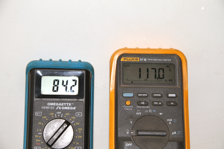

I have a UPS for my computer.
With no power supplied to the battery backup, the voltage showed around 80 volts when I was expecting around 115 volts AC.
Is that because I do not have an RMS meter?
Unless you are using a "true RMS" voltmeter, you will always get a reading between 80 and 88 if the power supply is working 100%.

I would say yes. Both of the below meters are connected to the same source, a UPS with a MSW (Modified Sine Wave) output.
118366
The meter on the left is an inexpensive average responding RMS indicating meter while the meter on the right is a true RMS responding RMS indicating meter so what you see makes sense to me.
Years ago a good RMS responding meter was an expensive proposition. Today they are relatively inexpensive and loaded with additional useful features. Just find one with the features you want at the price you want to pay.

May I just say, I hate the name of the left hand meter! :D
Nice comparison though - and as you say, true RMS meters are freely available now for very little money.
Yeah, but it was a free giveaway. :)
Ron
