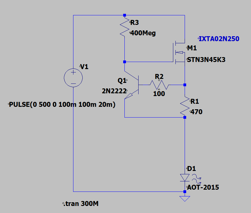

One more try.
This is a constant current source. In spice I used a 3N45 which is only good for 450 volts. I see there is/was a IXTA3N250 which is a 2500V transistor.
R1 sets the current limit.
M1 will get warm/hot. 1mA 1000V = 1 watt.
I have a collection of 2000V transistors but they are not in production now. With a little looking I think there are some available.

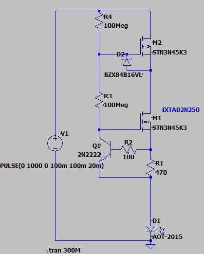

Using lower voltage MOSFETs.
Years ago I built amplifiers that had 2000 P_P voltage outputs.
Here M1, M2 share the voltage. So two 1000 volt transistors can 2000 volts.
Same as the old circuit M1 is a constant current source. M2 is set to take 1/2 the voltage.

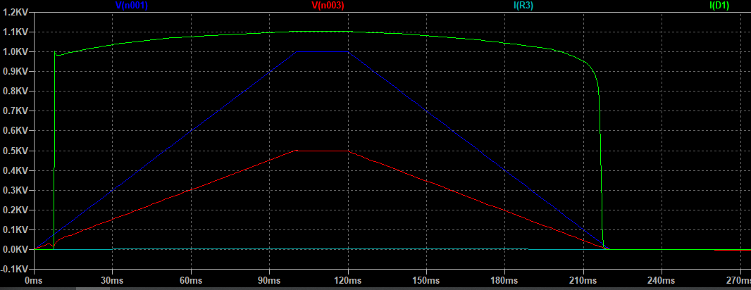

Blue trace is input voltage 0-1kV. Red is at the 1/2 point. Green is the current that holds within 10%.
