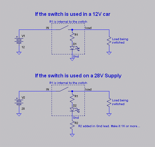

The switch has a small led indicator. I want it to switch on when I turn my 28v dc power supply. The switch is rated 12V dc. Is it ok to use with my 28v power supply? I guess this is why you said it might need an external current limiting resistor for the led because of my power supply being more than 12v?
Since the switch you posted is designed for automotive use, I am guessing that it is wired like this (you will have to verify):

You know how to figure out which terminal on the switch is which using an Ohmmeter?
hmmm.....no...I was planning to hook it up and see if it works, and if not, I would change the terminal. Now that you mentioned it, I would be interested to know how to test the terminal with an ohmmeter please.
Step 1. Put the Ohmmeter in the OhmsX1 mode (low Ohms). See what it reads with the leads open (my Fluke says "OL"). See what is says with the leads shorted (my Fluke says 00.4Ω).
Step 2. Find the two terminals (three possible pairs) that have near zeroΩ with the switch closed. Try both positions of the switch handle, so six total measurements. Note which two terminals appear to be shorted with the switch closed. One is the "IN" terminal (in my diagram), the other is the "load" terminal, but up to now, we don't know which is which.
Step 3. Put the Ohmmeter in the diode test mode (->|-). See what it reads with the leads open (my Fluke says ".OL"). See what is says with the leads shorted (my Fluke says .000).
Step 4. To find which of the terminals found in step 2 is "load", first make sure the switch is turned off. Connect the Red Ohmmeter lead to either of the terminals found in step 2. Connect the Black lead to the third terminal "GND" (which is neither "IN" or "load"). If no conduction ( .OL), move the Red lead to the second of the two found in step 2. If you see some conduction (about 1.700 on my Fluke, that is approximately Vf of the LED), then the second one of the original pair is "load", and by default, the other one is "IN".

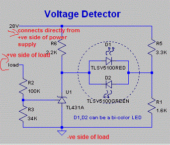

Thanks for your reply and schematics. I am newbie in electronics. I have to refer to the internet to make sure I read the diagram correctly. Please let me know if I got it right in the diagram annotation below.
I noticed that when the voltage is above 3V and below 10v, I have the red light turns on fine but the green one flickers. Do you know what is wrong please?
What is the nature of the 28V supply? Is it well filtered and regulated? Can you post a schematic or a link?
What is the "current limiter"? Can you post a schematic or a link?
I'm using a led driver for the 28V DC. I can't find the exact driver I'm using but it looks something like this.
The flickering arises whether I user the current limiter or not.
A constant-current Led driver is not a DC supply... Not even close. It would have been helpful if you had disclosed what is supplying the 28V? in your first post (or if I had been smart enough to ask).
The Voltage detector circuit I posted expects pure DC at the "28V" terminal, and slowly varying DC at the "load" terminal. Likely, you are feeding it Pulse Width Modulation which is switching from 0V to ~33V.

How did you measure the 28V? Using a DC meter? What load did the LED driver have on it while you were measuring it?
Is there an easy way to turn the led driver into a dc power supply?
No. By its very nature, a constant-current LED driver does not put out a constant output voltage. As the load changes, the LED driver adjusts its average output voltage to compensate for the changing load. It is the exact opposite of a constant DC power supply.
You should tell us what you are trying to power. It makes no sense to hang a "current limiter" behind a LED driver which intrinsically regulates current (not voltage)????
Ok I have figured out the flickering was because of the led driver. I substituted it with a printer adaptor with 30V dc and the flickering no longer occurs!
Does using 30v instead of 28v entail any change in your schematics? Also which resistor values I need to change if I want the red light to trigger say at 10.5v instead of 10v? Thanks.
...Does using 30v instead of 28v entail any change in your schematics? Also which resistor values I need to change if I want the red light to trigger say at 10.5v instead of 10v? Thanks.
Circuit will work fine with 30V.
Use this formula:
R3=R2*2.49/(Vin-2.49)
In your case, leave R2=100KΩ, and make R3 adjustable (using a pot, or a series/parallel combination of standard value resistors).
Solving for Vin=10.5V
R3 = 100000*2.49/(10.5 - 2.49) = 100000*2.49/8.01 = 31086Ω.
Obviously, R3 depends on the tolerance of R2. I would just replace R3 with a 27KΩ fixed resistor in series with a 10KΩ trim pot set to near mid range.
