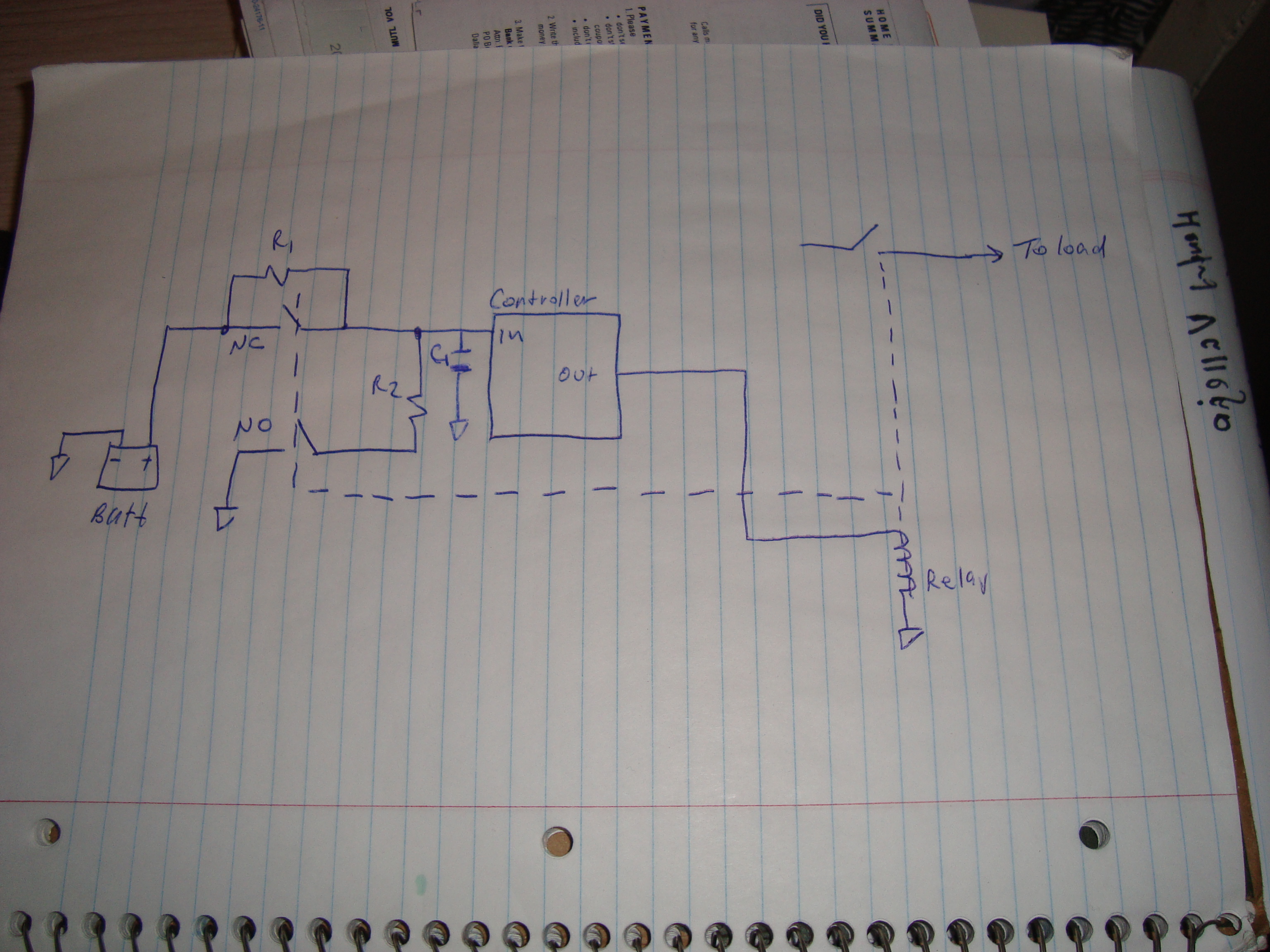

Here is a solution I'm pretty sure you can get to work. It requires one controller, two resistors and a dual, double throw, double pole relay. R1 and R2 form a voltage divider, which divides out the bump in battery voltage you get when the load disconnects. R1 should be connected to the NC contacts so it's shorted while the battery is connected to the load. R2 is connected to the NO contacts. When the realy is energized, R1 and R2 divide the input voltage down to a level that prevents the controller from reconnecting. The values depend on how high the battery voltage spikes up when disconnected. I can guess a value of 1K for R1 and 10K for R2 might be a good place to start. Capacitor C1 shold help prevent the input voltage from spiking up while the relay is pulling in. The other part of the dual realy connects the battery directly to the load ( does not go through the controller ) That connection isn't shown on the drawing.

PS: C1 will be critical to the correct operation of this circuit. It must be large enough to absorbe the spike. However, when connecting the battery, excessive current could flow into it, possibley damaging it. You'll need a series resistor to limit intial current. Again, the value will be determined experimentally. Another optoin might be to connect it across the relay coil to keep it energized long enough to pull in the contacts. On second thought, I think that's a better option.
Also, it occured to me that R2 can be connected directly and doesn't need to be switched. R1 should also be connected to NO contacts, not NC as shown.
