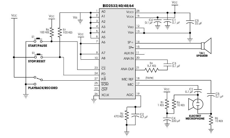

hi all,
i need help in understanding this circuit.//:confused:
can anyone help me out? :D

i downloaded the datasheet and went through it before this.
but, i do not quite understand how the circuit works as much as i want to
for example, what is the purpose of placing the capacitor C4, C3 and R4 there..
also, the switches S1, it's a push-to-make switch right?
does that mean that if i press once, it will start, and paused when pressed again?
please help.....

C3 is the ac coupling from the preamp to the main amp and conjunction with R4 form a simple frequency filter.
C4 is the voltage bias filter for the electret microphone.
R6 is a pull up resistor for the switches.
S1 is a 'start' push switch.
Select Playback or Record, then the 'Chip enable' ,,,, 'start' to record or replay.
S1? is a 'stop' push switch, stops Record or Playback and resets the ic ready for your next command. Look at page 8 of datasheet.
Note: the datasheet circuit and the one you have posted have different component idents!

I have another question.
I built the circuit according to the schematic provided in the datasheet.
Now, it works fine.
The problem is this, my speaker output is too soft.
By soft, I mean that the voice recorded is too soft to be heard but on the other hand, the noise from the background is too loud.
By the way, I placed a low voltage audio amplifier between the output pins and the speaker.
What should I do to reduce the noise while making the voice audible?
I was thinking of using a low-pass filter to filter out the noise.
If that is the case, what cut-off frequency should I use?
