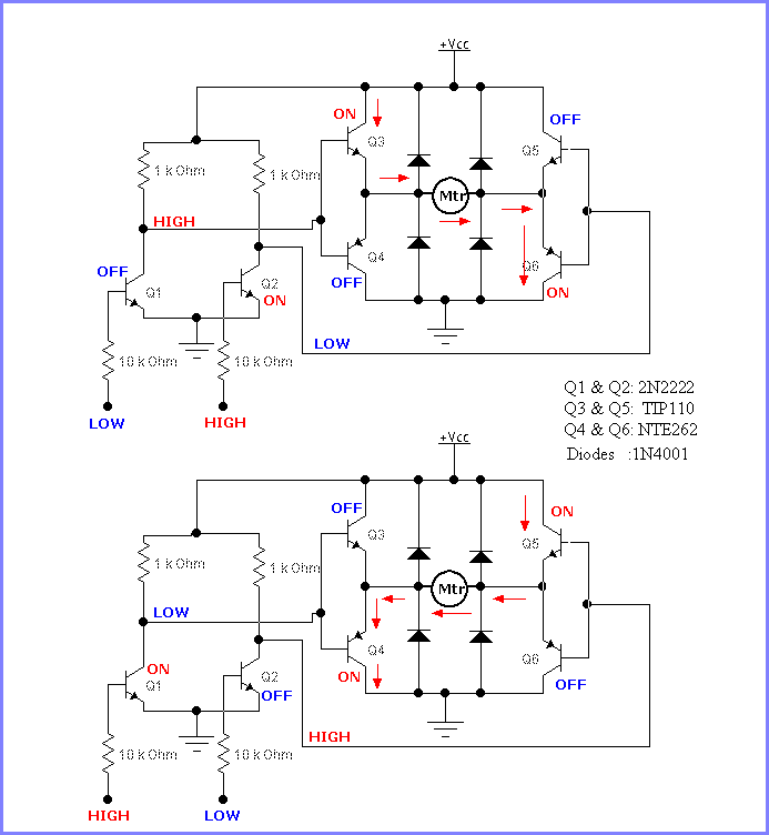

and also i am posting a h-bridge figure for u to be more clear.

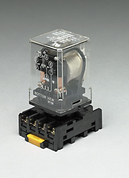

What is this DPDT relay? And how does this work?
If u could explain these to me, then I'll be very thankful.

DPDT is "Douple Pole Double Throw", two changeover switches controlled by a solenoid - it's a VERY common relay, and you can use it to reverse a motor.
As you're opening and closing a door, presumably you have "limit switches" to stop the motor when it's fully open or closed?. Because of this a DPDT relay, protection diode across it, a driver transistor, and a base feed resistor are all that you need to open and close the door.

In the circuit of the H_bridge posted by Emantra, can u guys help?
What is the use of the Q1 and Q2 transister?
Can't we just input the signal to the Q3-Q4 and Q5-Q6?
