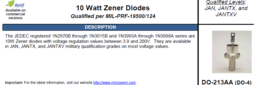

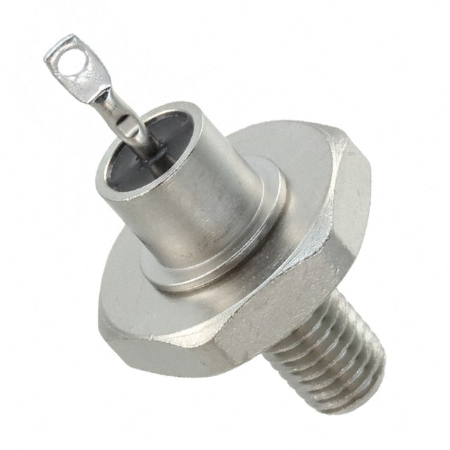

1N3311B DIODE ZENER 12V 50W DO5

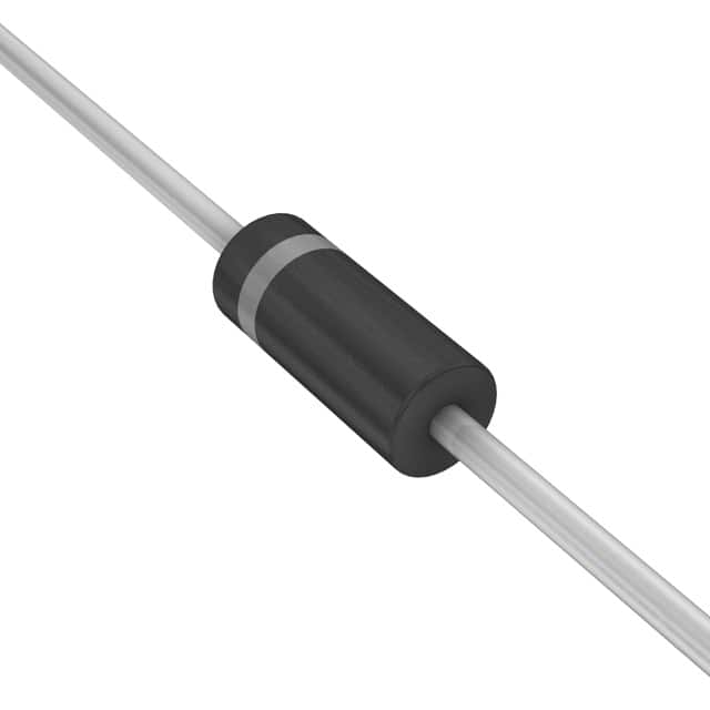

1N5349 DIODE ZENER 12V 5W AXIAL

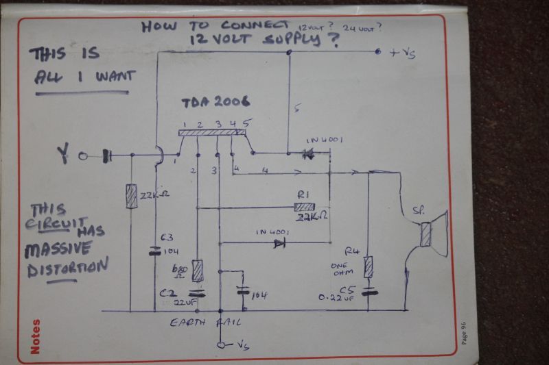

a TDA 2006 amp --- built 3 OF them ---as a preamp for my guitar --& simple PA mike amp ---
but the circuit schematic ---appears to differ from the actual etched circuit board I made
something wrong ---a mike or guitar jack input --initially sounds ok --but quickly distorts --
Its rated 15 watt -------
have tried every which way to correct it ---still growls annoyingly --my voice varies in pitch
---eventually it dies --then suddenly awakens sqwauk ---then ok --then zip ! weird --
( the other bigger TDA AMPS I made --all work fine ---
but this 2006 --something wrong with circuit components or configuration--

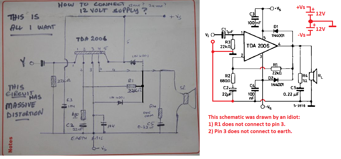

look at both SINGLE 12 V Supply circuits shown in the PDF --
a 22 MF cap is missing in the lower circuit --some values are altered -----maybe my 30 watt speaker (4 ohm )
is overloading the 2200 cap out put --or maybe faulty IC ?( INPUT is a clean guitar single coil jack --no FX)
appreciate if you can get this circuit to work ?
if not ---many thanks for the Zener clarification ---
Zamdude
The datasheet for the TDA2006 shows an output of 12W into a 4 ohm speaker with horrible 10% distortion with a 24V supply. Its power is 2.8W into 4 ohms with 10% distortion with a 12V supply. Its power is 8W into a 4 ohm speaker with low distortion and a 24V supply or is 1.8W with low distortion and a 12V supply. The schematics and pcb designs in the datasheet are for a dual-polarity supply and for a single-polarity supply so of course they are a little different.
A TDA2005 has two amplifiers that are in a bridge so that it can produce about 12W with low distortion into 4 ohms and a 12V supply. The datasheet of the TDA2006 shows a bridged amplifier with two ICs driving an 8 ohm speaker.
Since your voice comes and goes then it is probably overheating and shutting down to protect itself. Maybe your heatsink is too small or is enclosed.

Can you explain what exactly is meant by SPLIT POWER SUPPLY ?
2 x 6 volt batteries --with MID connection to ground ?
or 2X 12 VOLT batteries ---mid connection to ground ?
( The datasheet says 12 volt + /minus supply (SINGLE supply -yet I think its split supply (2 x 12 volt batteries in series)
mid connection goes to that weird T shape ground icon ---
the other goes to negative---
or does one use 2x 6VOLT batteries in series
Can you show me tda 2006 circuit ---with relevant battery /voltage hookup ? (diagrammatically )?
( That does not crackle &p pop?
some SCHEMATICS show only 12 volt supply to pin 1 ---tda 2006
(spent 24 hrs building another circuit --less components ---
still distorts -----
The bridge (two IC AMP ) shows split supply AND single supply
but 5 amps later ---ALL are weak or crackly ---despite FAITHFULLY copying EXACT schematics --over & over
( some show 100 MF Cap --in parallel with 104 ceramic caps (shown with dotted line )
connected to pin 3 (negative )
not sure if this is alternative arrangement --or together /?
Appreciate any clarification /diagram --of the correct (single ) IC 2006 connection
Most grateful for your patience ----I will get it right eventually !
Best regards ---- Zamdude
The signal on a speaker must swing positive and negative. But an audio amplifier with a single positive supply has an output with DC always on it which is bad for a speaker, so an output coupling capacitor is used to feed the speaker with AC that swings positive and negative. A split supply has a positive voltage and a negative voltage then the output of the amplifier can swing positive and negative then no output coupling capacitor is needed.
[2 x 6 volt batteries --with MID connection to ground ?
Yes, then the amplifier output to a speaker can swing up to about +4V and down to about -4V.
Yes, then the amplifier output can swing up to about +9V and down to about -9V.
+/- 12V is positive 12V and a negative 12V for a total voltage of 24V, it is a split supply. A single positive 24V supply will work the same if a coupling capacitor feeds the speaker and if the input of the amplifier is biased at half the supply voltage.
( That does not crackle &p pop?)
The spec's, schematics and pcb designs on the datasheet show a +12 and -12V split supply and a positive 24V supply. Its output power is shown on a graph to be very low with only 12V.

Any amplifier distorts if its output is clipping because the input level is too high. Any amplifier built with a poor pcb design oscillates at a high frequency which causes severe distortion.
The datasheet shows proper schematics and recommended pcb designs.
It shows only a split supply. A single supply can be used if the amplifier inputs are biased at half the supply voltage.

They also show a dotted C8 and R5. The datasheet tells you that all of them are to prevent oscillation.
connected to pin 3 (negative) not sure if this is alternative arrangement --or together /?
The datasheet shows that pin 3 is grounded (0V) with a single supply and is at the negative supply with a split supply.[/quote][/quote]

All I need is a diagram --showing HOW the batteries --(single 12 volt )or 2 x 12 volt --or 2 x 6 Volt
can be correctly coulpled to this nightmare growler ---ALL connections are solid --triple tested
I have made so many -- driving me bonkers ---all distort exactly the same ! 7 units made --
all identical -----the twin TDA Bridge are the worst -----
this is all due --I am certain --to INCORRECT VOLTAGE SUPPLY !

I got a hookup diagram from a fella -------which clarified it all ---
ie TWO BATTERIES ------ with the MIDWAY connection to the strange T SYMBOL --that keeps me baffled
I seriously need a schematic showing the exact Battery type ( 12 volt single --or 12 volt double --or 6 volt double -series of batteries)
How on earth does a single 12 volt battery be ""SPLIT VOLTAGE ?"--- where does the THIRD connection go to ??
single 12 volt lead acid battery has 6 cells ----only TWO TERMINALS ---- so---
HOW can 12 volt be SPLIT ---into 3 ?
OR is it a serious misprint ?
( I have only ONE 12 VOLT battery --fully charged --new )
do I have to purchase another m/cycle battery --? to get this nightmare to amplify voice ?

here are two schematics --I tried to use --years ago ----
still ---distortion ruled!

A simple clear schematic with red & green connections from ONE A OR SEVERAL BATTERIES
will eliminate a thousand complex tech jargon phrases ----(square wave oscillation ) swinging voltage from pos to neg --
on DC supply ---is frightening !! ---AC sine wave oscillates at 50 hertz ----
but DC VOLTAGE swing up & down ---pos to neg --in this circuit --sounds awful !
apologies
just want to build a 12 watt amp ---for ANY weak or loud voice signal input --

Your amplifier was a copy of a very poorly drawn schematic. I show my corrections.
The amplifier is supposed to drive a speaker with power but the power from those cheap little 9V batteries is much too low. A bunch of AA alkaline batteries might last for a few minutes at full power.
This is a power amplifier designed to be driven from a radio tuner or MP3 player. A microphone has such a low level that it must feed a pre-amplifier circuit that feeds this power amplifier.

You have redrawn the circuit --EXACTLY the same as I did -----years ago ---
The schematic does not show the "skip over " on R1 --and Pin 3 does not go to neg earth ==ok
I redtified this years ago with help from this forum ---
However ------your corrected drawing is what I had been using for years!!
it SIMPLY KEEPS DISTORTING !!!!!------
