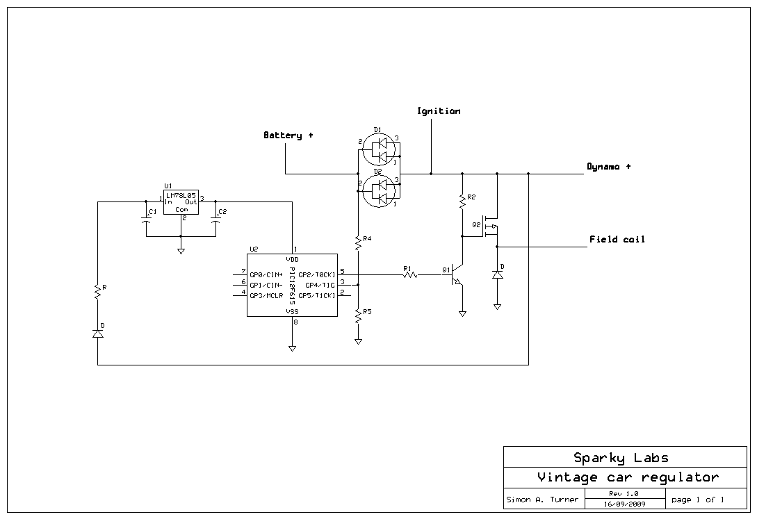

I made a number of homemade refits of those old buzzer regulators using a simple op amp voltage comparator circuit and a large transistor for the field control many years ago. They fit inside the original regulator housing and always worked well. I still have my original one from about 20 years ago and its still in service!
It just basically a slightly modified version of a stock external regulator the older Ford alternator systems use.
I used them on our old farm tractors until I got around to electrical system upgrades and installed high output alternators in order to keep up with modern lighting loads that were added then.
how are you controlling the switching speed ? surely a comparator driving a power transistor will just ran as fast as the comparator and/or transistor can switch ?
That basically all it was. The actual field coil inductance will limit the actual speed to about the same realistic rate the buzzing contact system used. Or at least it seemed to have the same basic output characteristics only without the spiking and RF hash. As I said before it was rather crude but did prove it self effective at holding the system voltage more stable.
Well I tried out the attached circuit and things have been a bit hectic. now firstly at some point I had trouble around Q1 as nothing i did would make it switch full on and hence deliver a clean signal to the mosfet gate. anyhow at some point after some proding we got it to work but only when the field coil was powered via the battery did it work proporly, when we put the field coil supply onto the armature output it just ran until we pulled it off at 16.5 v battery voltage.
to remove all doubt I want to make the circuit on a soldered board rather than breadboard in case of faulty connections as at 1 KHz there should not have been a problem.
for some reason Q1 was always at 10ish volts on the collector instead of 0.2 volts when on

I made R1 a bit high maybe, I have changed this for a 1 K resistor which will give (at average hfe) a current capability of 300 mA on the collector, I've soldered it all together so hopefully will work better tonight !

well now i have a problem where the mosfet is not fully off, I seem to be having problems with the drive transistor (2N2222A), maybe an npn arrangement is better ? I think the problems are something to do with the two different voltage supplies in the circuit
