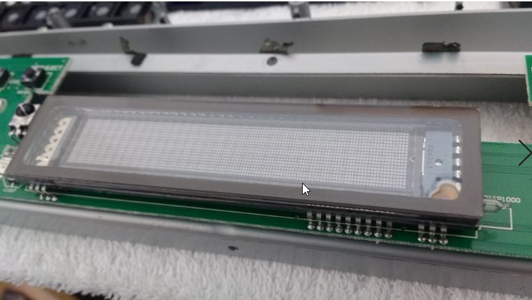

Have a display 128 x18 thats going faulty, loosing the intensity on some of its horizontal lines.
When checking it out, found that it had a type of ' burn' mark, bottom right, but no idea if thats a normal manufacturing mark or something more recent suggesting the display is failing ?
Gather they naturally loose their intensity over time, this ones about 12 - 15 years old and been in continous on / use.
The display has a barium getter, barium is deposited on the glass during manufacture, its there to absorb an gases left during manufacture amd outgassing of the metal parts.
Dont worry about it.

I'd say that was a getter mark from when it was manufactured.
At 12-15 years old the display has already lasted much longer than most, VFD's are particularly short lived and unreliable - they look nice when new, but are pretty poor long (or even medium) term.
Essentially it's a valve, so emission drops as it ages, then it uses phosphors to create the visible light, these lose efficiency - rapidly while running in, then more gradually over time (it's the same 'wear out' mechanism or CRT's).
Thanks for that info, not a device I have worked on before, its part of a decent hifi system.
Seems I need to replace the VFD as a matter of course just due to age and the 12+ years of continuous use, though there could always be some further problem with the driver etc.
Because its a more unusual 18 dots wide, seems the usual uk suppliers do not stock this particular model, though Noritake Itron US do list it as a current model at $56, so have mailed their uk office to see if they can help ?

'Sometimes' the heater voltage is fed via electrolytic capacitors, and these do fail - however, even if they are faulty replacing them genarally only provided a little improvement, if any, and only very rarely a cure.

At least it's only dots, most are special custom symbols and shapes - what make and model is the unit?, perhaps you could get it as a spare part?.

Its an original Arcam Solo all in one unit (tuner/cd/amp), now well obselete, they will not deal direct with their users, you have to take / send your unit off to a local dealer who will then send it to Arcam for a repair quote, if they still have those parts in stock. Costs £40 just to send it to them, so doubt any repair will be cheap.
Could almost do without the display for most things, but trying to change channel on the fm/dab tuner would be difficult, though suppose I could just stick a more modern fm/Dab+ tuner on top.

Point I'm getting at is that if you surf ebay you might be able to find one of these and then you could remove the glass vfd panel from it and fit to to your system.
You'd be taking your chances but I cant thinkof a better way.
Apparently you can rejuvenate these displays, sorta like a crt rejuvenate, dont know if it lasts, if you do this you take the risk yourself I've never tried it, you might end up blowing it.

His is a dot matrix display, so not two or four line, and as far as I'm aware VFD's have never used 4 or 8 bit interfaces?, they are high voltage multiplexed bare displays - at least all the many I've seen have been.
EDIT: Just been and checked the datasheet he linked to, it's got a serial interface inside the glass, looks like a type of SPI connection - no wonder it's pricey. I'ne never seen one like that, but i suppose with the huge price of Arcam they can afford to splurge out on parts :D

Rejuvenation only improves the cathode emission (if it doesn't destroy it totally - as it BLASTS contamination off it), and as I pointed out (and you did as well) another issue is the phosphors wearing out.

Noritake has marketed LCD-pin-compatible VFD displays for some time. A few years ago, Noritake was on a hobbyist/DIYer push, giving away many of their LCD-compatible displays and providing Aurdino drivers and sample code to support and promote their use.
