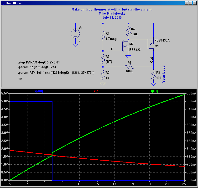

Here is a design based on this thermistor. Power supply is 5V. Quiescent power draw prior to switching on is less than 1uA. It has positive feedback, so it switches on with a nice snap action. I have it switching a 50mA, 5V load.
R2 models the resistance of the thermistor as a function of temperature. Note that as the thermistor cools down from 25degC toward 10degC, the circuit snaps on.
The circuit is a bit simplistic, in that it relies on the threshold voltage of the BSS123 to establish when it fires. If you build more than one, you will likely have to adjust R1 in each to get a specified trip temperature. Raising R1 reduces the trip temperature.
Ask if you dont understand something. This was simulated using LTSpice, but has not been breadboarded.

Hello Mike,
it took a while to study electronics and LTSpice. I undertand basic mechanism in your design: When Nmosfet is shut down, current starts to flow via Pmosfet. But there are still things I don't understand, even I have spend some time with your design.
Firstly, what is purpose of R6? Circuit seems to behave odd way if R6 is changed, it might not shut down or shuts down only for certain temperature range. Why is that ?
What is purpose of R5?
Why BSS123 transistor is so special, that no other transistors seems to replace it properly. Is there something to do with high ON-mode resistance RS(on) ? Why is that ?
I would apprechiate answers for those questions. Best regards,
Dknot--
If anyone have any clue/ andvanced guess about R5,R6 and resistance of BSS123, I would apprechiate it very much ^^
Dknot--
R6 and R5 are a voltage divider which takes the 5V swing at the OUT node and reduces it to about 50mV. That 50mV step is added to the bottom end of the voltage divider consisting of R1 and RT (the sensor). That manifests as positive feedback (hysteresis) to the gate of M2. This is what cases the "snap-action" switching behavior. If R6 is too low, you get too much hysteresis; if it is too high, you don't get enough, and slow turn-on.
Already answered above. It is small compared to Rt, and ratio-ed against R6 to produce the appropriate amount of positive feedback.
Why BSS123 transistor is so special, that no other transistors seems to replace it properly. Is there something to do with high ON-mode resistance RS(on) ? Why is that ?...
The BSS123 is a N-Channel Logic Level Enhancement Mode Field Effect Transistor, which is "suited for low voltage, low current applications such as small servo motor control, power MOSFET gate drivers, and other switching applications". I set it up for high-gain, low-current by using a 100K load resistor.
