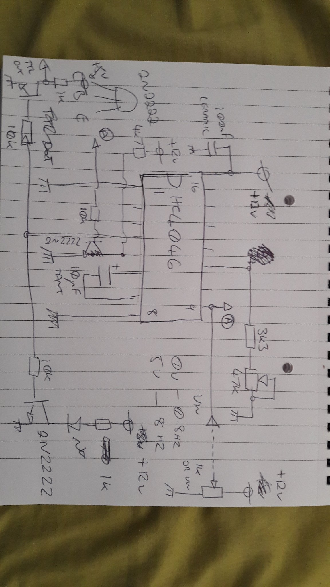

Muso, remember the circuit I posted, I got it to do as your spec, it stops completely below 0.6v input, I just added 2 resistors and a transistor, the chip is disabled below 0.6v.
The circuit might need some slight value tweeking, but it works ball park, on 12v from 0.1hz to about 11hz, if your interested let me know.

dr pepper you are a star!
That would be to my advantage as a dc motor dosn't start to turn untill aboult 1.5v which would have an effect, but as you say it can be tweaked.
Is that the V drop over one of the transistors (the .6v)? As I alluded to above one thing not mentioned was that a dc motor will not turn until aprox 1.5 - 2.0 v
Obviously the above will not impact on that but it would seem feasible if it were a 'junction' to sort of calibrate it to the movement aspect with additional diodes.

Ok the, heres the modded schem, note that the supplies are all now +12v, and there is bottom left a level shifter transistor that gives you a 0-5v Ttl compatible output, or if you want you could make this 3.3V, note the resistor on the collector goes to +5v not +12v.
12v makes the circuit works a lot better, the 4046 is a cmos cd4046, a 74hc4046 would not work here, but the cmos version 4046 is still common.
Instead of a 2n2222 you could use Bc547, 2n3904, Bc107, Ztx457 etc.
Hi drpepper,
many many thanks for the circuit. Would this be ok?
Also, have 15v circuit to hand from previous project. Can it be used? Do not see any probs.
Finally for the moment, I am assuming the 47k pot adjusts output frequency? And just one more thing (for the moment) What is the 1K pot on pin 9 doing? Is it a trimmer?
