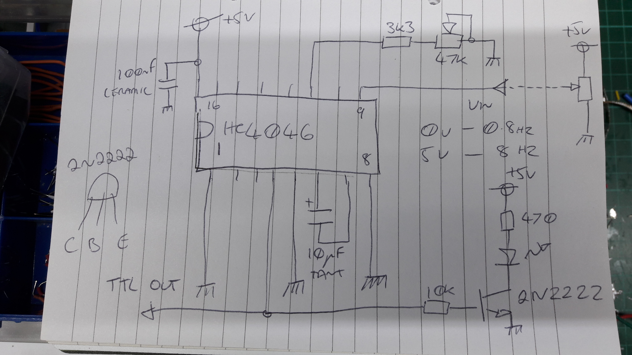

I've played with sound with 'duino's & Sd cards, not hard to do, & beleive it or not I messed about with a callesen marine diesel sound rev wise, its tricky to do, you have to slice & patch files to get rev changes, I didnt really get it to work, but it was only a sunday aft playtime.
The circuit attached goes from 0.8hz to about 8 hz, so not so much use, its tricky to do, the ne567 wouldnt even do what the 'hc4046 does, I think to get the thing to work you'd have to get down to a low freq with the vco then using a comprator monitoring the control voltage stop the osc near ground control voltage, that would be tricky to get right as steam engines dont suddenly stop. I have to say at this point I'd be reaching for my arduino, or maybe a attiny 8 pin job.

You do not consider the AD654 viable then?
