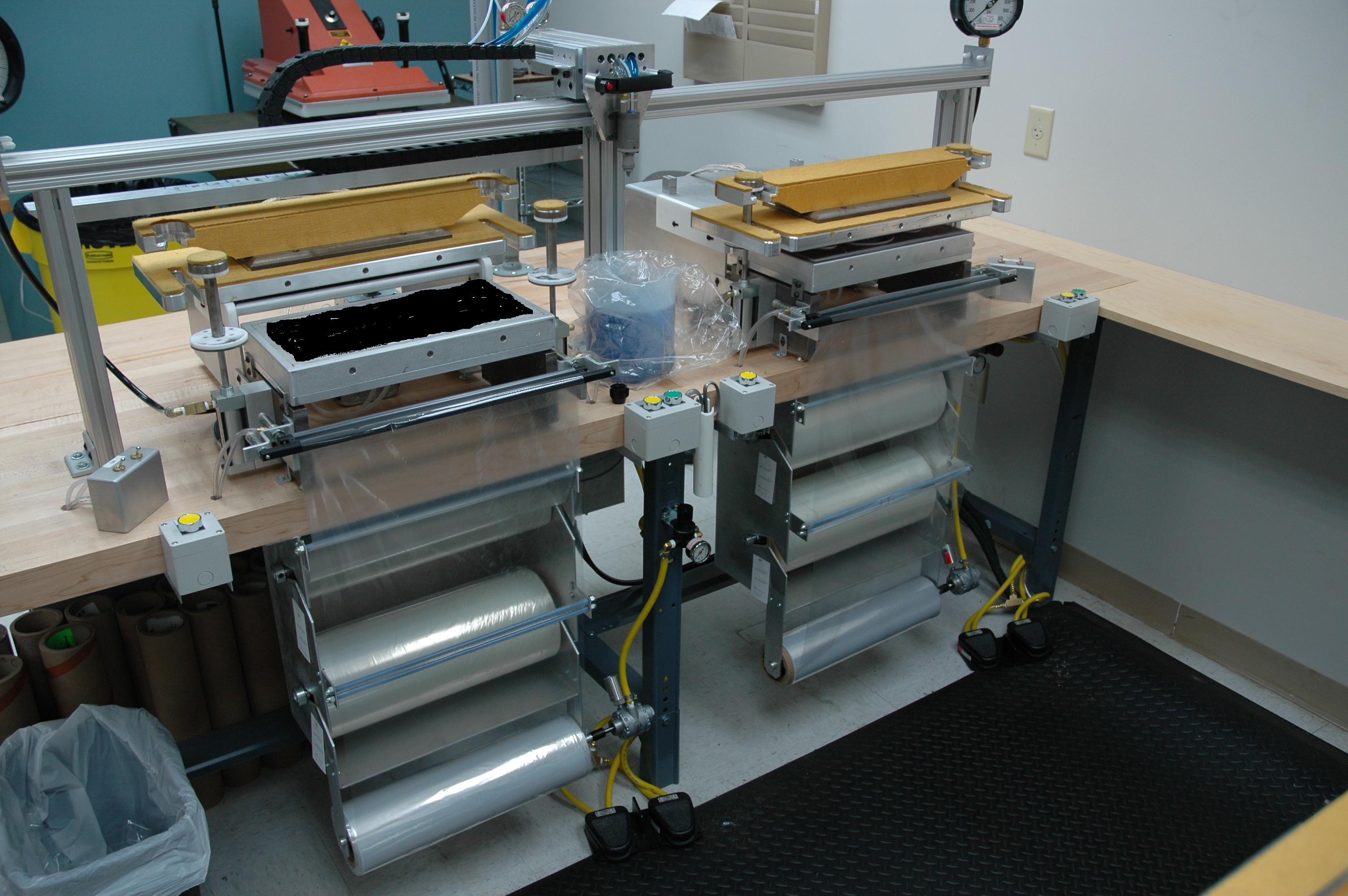

Here is a typical project for us, granted, this is far more complicated than something I would be trying to implement in a uC, but It's something to look at.
To understand whats going on;
This is molding / heat seal machine, The plates have mold cavities which the sheet plastic is pulled into via vacuum, the nozzle meters out a 2-part mix (+/- 1%), the size and ratio varies based on the "recipe" selected.
The two hand buttons clamp the press to seal and bake the part and a count down timer begins. After the timer counts down, the mold opens.
All the while the four mold plates are maintaining heat +/- 1.5 degree via PID loops. (no external temperature controllers, PIDs are part of the PLC) There are other secondary functions such as temperature deviation alarms, temp probe averaging, probe fail indication, auto heat start via real time clock/timer, finished parts counters, prototype mode, storage of 20 recipes, etc.

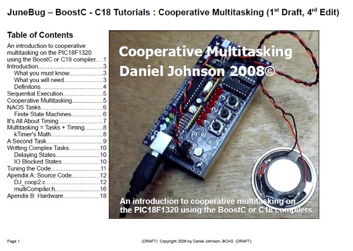

C or any procedural language can work in much the same way as ladder programming.
A main loop checks each task in turn and activates it only if the task is ready to run. It could be waiting on a timer or blocked waiting for IO. In either of these cases it is skipped.
A while back I wrote a detailed tutorial illustrating ) but it can easily be used with any working PIC.
