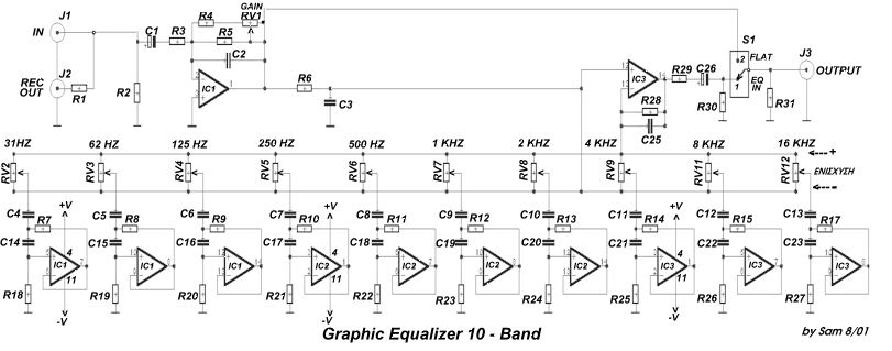

Hello,
Oh still used a lot in audio equalizers? That's quite interesting really. Perhaps you can show a schematic for one with a gyrator, i wouldnt mind taking a look at one.
Inductors large and expensive for equalizers? Are we talking about the typical equalizer built into some amplifiers or are we talking about an equalizer that has to connect to the output of a somewhat higher powered amplifier and drive the speaker directly?
for instance a typical 10-band eq is shown below...
this is a common design and still in use

looks like 2001 according to the date in the lower right...

Hello again,
Hey it's nice to see someone else interested in this stuff :-)
I didnt realize there were so many graphic equalizer schematics on the web either, and the 'gyrator' we are talking about from your schematic looks like what i remember from way back when (years and years ago :-) ) so it was even more interesting for me to see this circuit surface again.
From the standpoint of looking for a simplified analysis, it looks like you have it well in hand. However, i prefer to take the stance that the op amp with the two resistors and one lower capacitor constitutes a simulated inductor with series resistance, and seeing it in series with the second (upper) capacitor, that constitutes a tuned RLC circuit who's parameters can be easily calculated and thus make the analysis short and sweet :-)
In fact, that op amp, two resistors, and one lower cap, come very close to a true RL circuit with the error being greatest at the higher end of the audio spectrum (where we get to 20kHz) and then the denominator starts to reduce the gain, but only by about 0.77 and so the impedance of that part of the circuit looks very close to R+s*L, the exact same impedance of an RL series circuit. For the lower frequencies it is so close to an equivalent RL series circuit that the error is way down in the thousandths of 1 percent or so.
In fact, if we call the feedback resistor R2 and the lower resistor R1 and the lower capacitor C1, we get an impedance very close to this:
Z=R2+s*C1*R1*R2
where we can immediately spot that R2 is the series resistance and C1*R1*R2 is the equivalent inductance.
That makes calculating the center frequency very simple as usual:
Fc=1/(2*pi*sqrt(L_eqiv*C_upper))
I like to look at it that way because it makes the circuit look just like an equalizer with a true inductor with series resistance in it.
Very interesting if you ask me.
