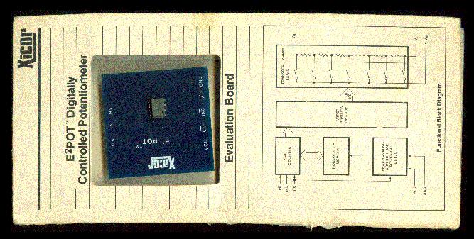

Hi Prprog,
There is such a "thing", it's called a digitally controlled potentiometer.
It's not controlled by a voltage but it's relatively easy to use.
Xicor used to produce them, now they are available from Intersil.
https://www.electro-tech-online.com/custompdfs/2008/03/FN8185.pdf
You could give that chip a clock signal, say 20 Hz or so, and control
it with a 3 position DPDT switch. Up / 0 / Down
One switch is for the chip enable and the other switch is for up or down.
on1aag.
