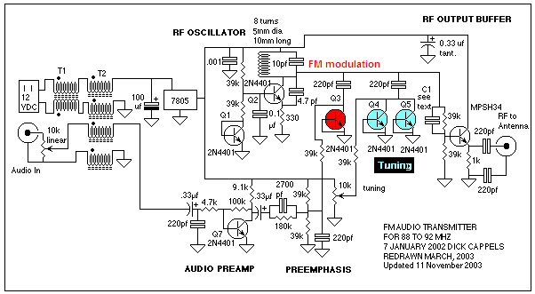

Varactor-tuned FM transmitter.PNG The capacitance of ANY semiconductor junction (diodes or transistors) changes when the reverse voltage changes.
Then a simple one-transistor FM transmitter can be made.
Here is an FM transmitter that uses one transistor for FM modulation and two paralleled transistors for tuning:

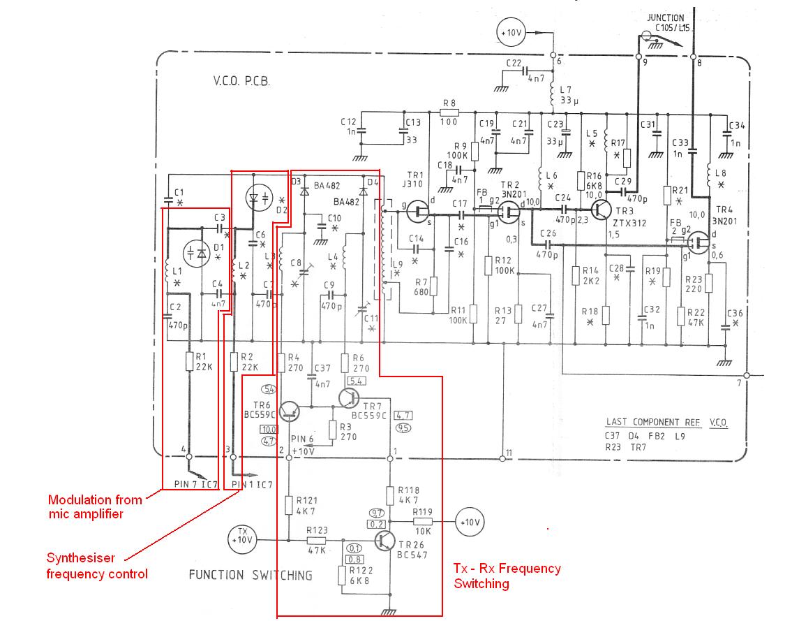

Have look at the attached fragment from a rather old (1980s) VHF radiotelephone, a Pye MX294 to be exact.
There is a varicap diode (D1) for the modulation, a second varicap (D2) is part of the frequency synthesiser control.
There are also two switching diodes D3 and D4 which are used to switch the trimmer capacitors C8 and C11 to help give a rapid frequency change between transmit and receive.
