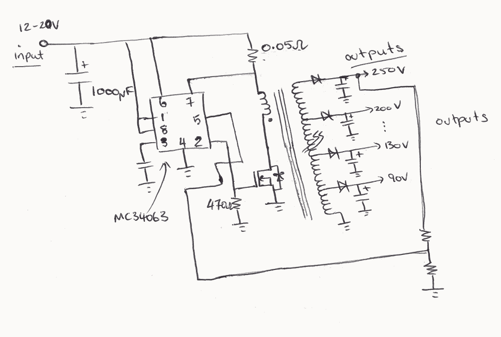

Hi. Because you have many high fixed voltages, a flyback converter would be a suitable topology. If each output provides 50mA, you have a maximum of 42.5W needed to be converted.
If you're powering it from a 12VDC source, then the attached schematic might work for you. Only one output is regulated, but all others should track; you should connect the feedback to the supply rail that has the largest current load.
If only one voltage is used at a time, then the maximum output power would be 12.5W. For that you could use a flyback converter with a single output and a variable voltage adjustment using either a pot or a selector switch with a different voltage adjustment resistor at each position.

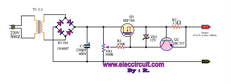

I am just wondering if it wouldn't be better in my case to start with a high voltage transformer?
You could start with a 1:1 isolation transformer (you will need isolation regardless of your methodology), rectify and smoothe, then drop the volts with a power FET as needed, under micro control. The FET would be heatsinked (heatsunk??) to handle ~ 12W max.
Edit: To reduce risk of electrocution from those high voltages, could you manage with fewer mA and current-limit at, say, 20mA?
Thanks Alec!
I looked that up, and found a relatively simple circuit, that does exactly what I need:
I was thinking about controlling the voltage by using a digital potentiometer, but this seems rather difficult with these high voltages. Is there any way around this?
I simulated this circuit, and it has a sawtooth-like ripple on the output. I am using the voltages for fairly high impedance loads. I thought about using a smoothing capacitor, but I'm afraid the initial surge current might destroy parts of the circuit (like the control part) Is there any other way to reduce the ripple on this circuit?

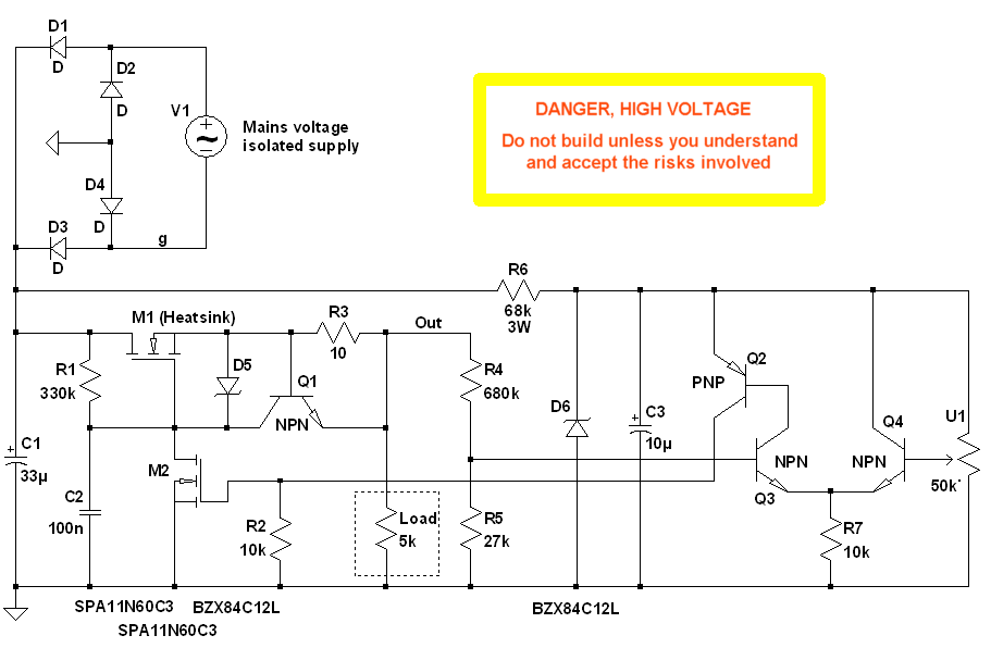

Here you go. Output voltage adjustable ~ 30V-300V at up to 50mA with low ripple. Current-limited at ~ 65mA.
Edit: The adjustment pot could be a digital one, controlled by a MCU.
BEWARE HIGH VOLTAGE. Take all necessary precautions.
