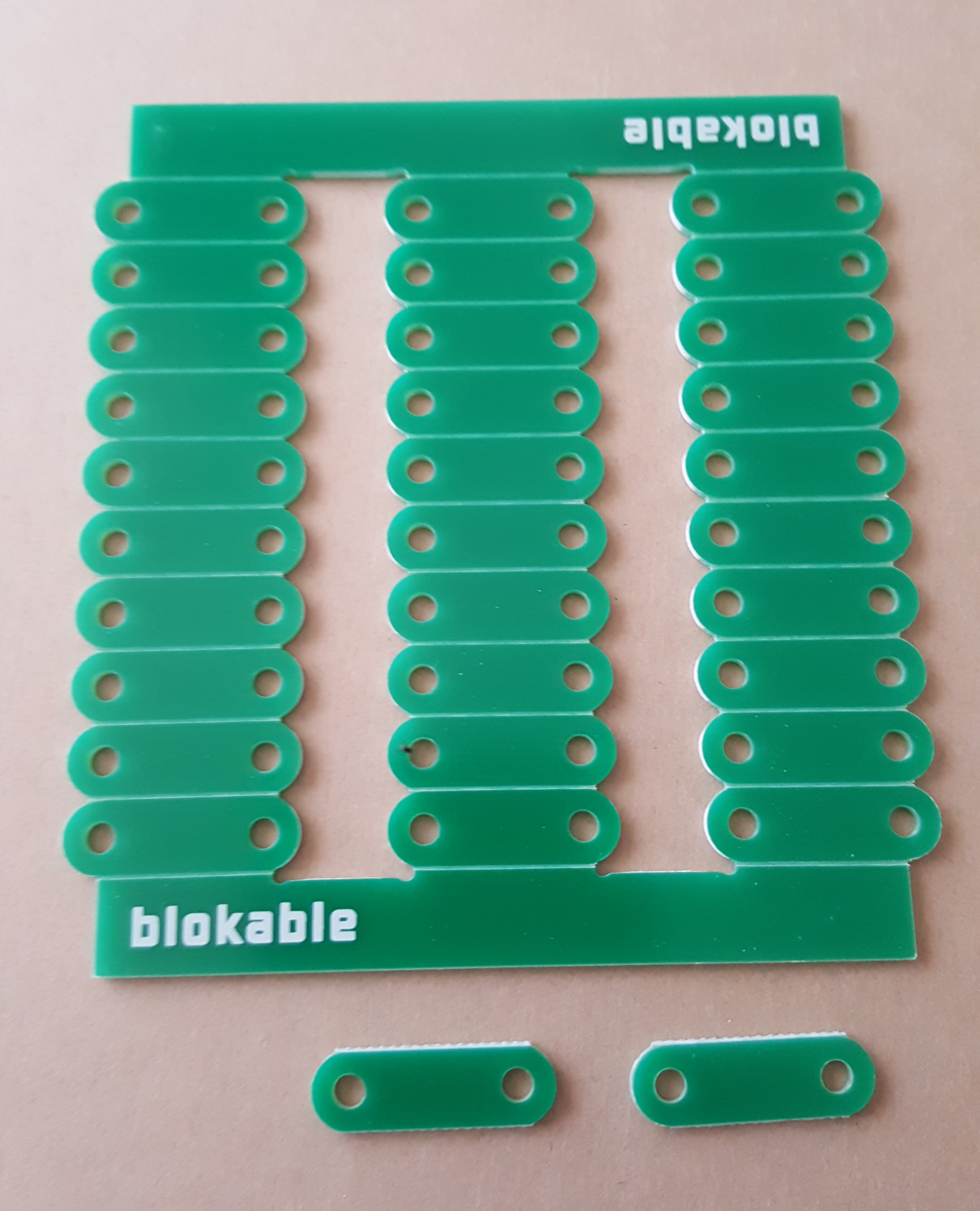

I was considering how to accomplish some stuff recently, and noticed Elecrow (one of the Chinese board fabs) has free V-score for one design on a board. I needed some long thin strips for mounting boards on a rail panel in an enclosure and also some smaller strips for using cable ties in same rail panel.
Taking advantage of free V-scoring, and adding internal routing, I came up with this panel. Three columns with 10 pieces each in a 100mm×100mm board. I got 300 of these pieces for $5!

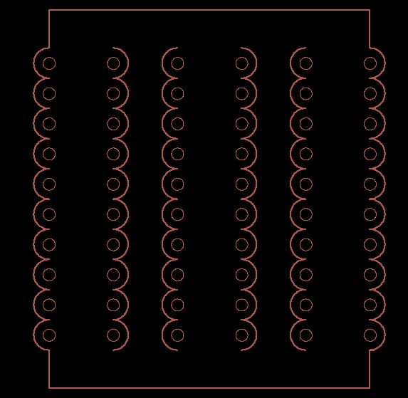

A few pictures will help to clarify this. The first is a screen shot from Eagle. The black line is the board outline. The blue line is the milling layer, which represents internal routing. The pink lines are the v-score layer.

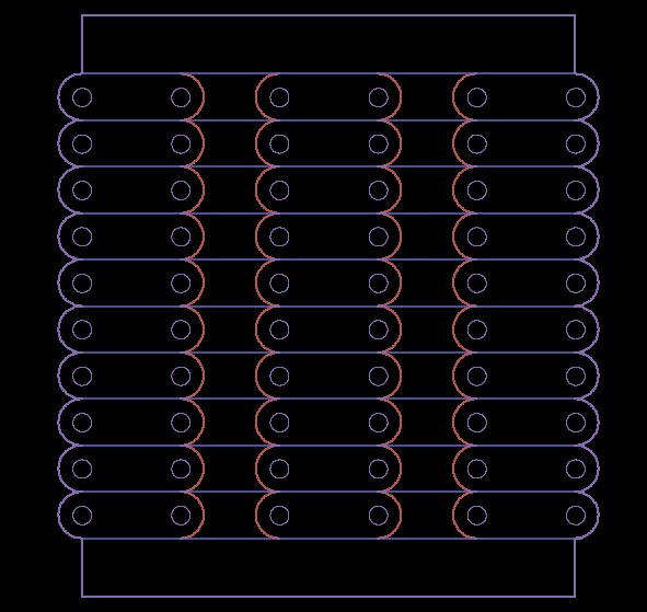

The next picture is the GML - Gerber mechanical layer. It shows the internal routing and the board outline; I include the board outline on every layer to prevent any confusion. I may have done this incorrectly I just realized... I think the straight sides at the top and bottom of the internal routing should have been included on this layer to be completely clear.

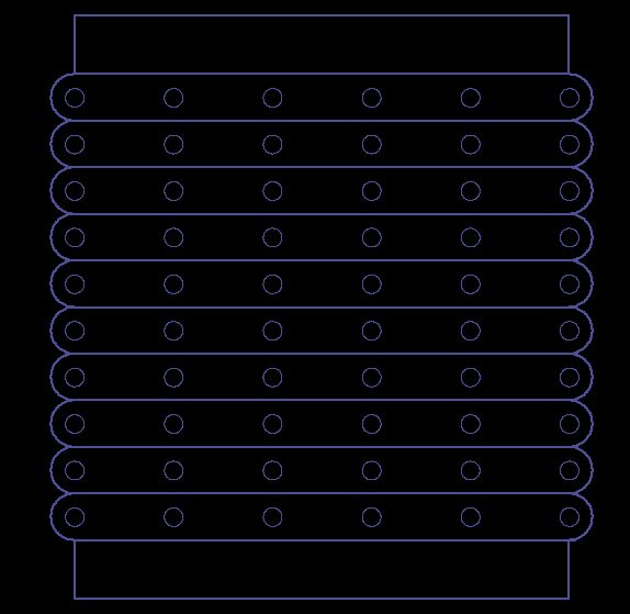

The next image is the Gerber GKO layer. It shows the horizontal lines for v-scoring. Keep in mind that v-scores are a straight line all the way across the board.

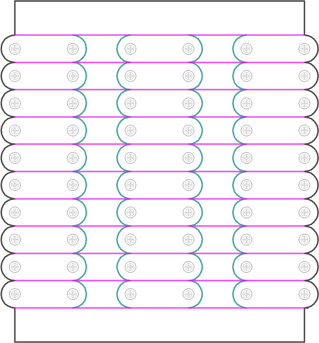

Showing both layers shows how everything works together.
