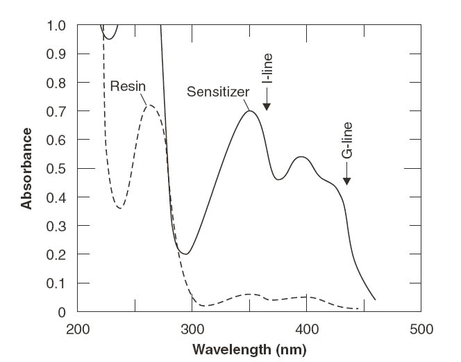

I have a large pdf document (too large to attach) that has absorption spectra for photoresists. Since Novolak is common, here its spectrum:
untitled-1-jpg.35675
Note that a sensitizer is often added to move the active absorption to longer wavelengths. The effective max is at about 360 nm. (The I line refers to the mercury emission spectrum and is 366 nm, as I recall. Edit: Wikipedia lists it at 365.4...close enough.) A less intense absorption is at 400 nm, which explains why the longer wavelength UV also works.
Long story, short, I would use the 360 nm LED's at $3.15 each and pocket the change. Are the outputs of the 360 nm and 395-400 nm LED's about the same?
The glass hold-down is probably not as big a consideration as the transparency. To my dismay, my favorite transparency (Pictorico Premium OHP film for Inkjet) was re-formulated to include a UV blocking agent. It's main use is in graphic arts and absorption of UV makes the image more vivid or something.

Thanks again, John,
so with 360nm I'll just be right on the money then.
There are no data available for the 400nm LEDs at my electronic supplier. I only know the LEDs look pretty dull and even looking directly at them won't harm an eye.
340 and 350nm UV-LEDs don't emit visible light, but 360nm do. The power output of the 360nm LED is 500 to 1000µW.
I'll try it and keep you informed about the outcome.
