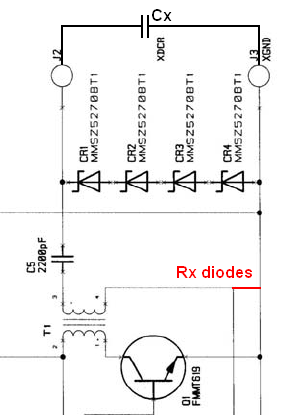

From the sample schematic (far bottom right where the transducer is):
https://www.electro-tech-online.com/custompdfs/2007/11/650020module20spec.pdf
It seems that the transformer is working more like a flyback inductor (with the transformer step-up) to provide the high voltage drive, rather than operating like a normal step-up transformer as I originally thought.
THe PDF also mentions that at the end of the 16 pulses that are transmitted, a 200VDC bias remains on the transducer for the receive operation. Is C5 just there to stop the transformer's primary from draining away the charge (and killing the DC bias) that's in the capacitance of the transducer during the listening phase?
It seems that might be easier on the transformer, as far as initially charging up C1 in kchriste's DC bias circuit goes.
EDIT: On second thought, maybe C5 acts as a DC-bias storage capacitor (rather than a DC-blocking capacitor to retain the DC-bias charge on the transducer capacitance). DUring the listening phase the primary side of the transformer is open circuited so the secondary would appear as a small series combination of winding resistance + winding inductance (appearing as a DC short) which are in parallel with the capacitance of the transducer plates?
EDIT2: I think the thought in my first edit is wrong since the polarity of the charge on C5 and the transducer places aren't charging each other, they are facing the same way the capacitors discharge through the seconary winding resistace of the transformer- which leaves me at a loss as to how the circuit is able to retain the DC bias on the transducer capacitance for long enough since it just gets leeched away by the transformer secondary winding resistance. C5 also seems to form a capacitive divide with the transducer capacitance so I have no idea how it works anymore.
I think your first EDIT is the right one: during the 16 pulses; C5 with the zeners acts as a DC clamper circuit. C5 is charged up when the zeners conduct in the forward (not zener) direction creating a DC offset to the AC waveform. When the Tx transformer goes dormant, it acts as a DC short putting C5 in parallel with the transducer and thus supplying a DC bias during Rx.
Problem is I can't see how current ever flows in the zener forward direction. During the flyback voltage spike current flows out of pin 3. The transformer has a dot at pin 1 and a dot at pin 3 so the current. At least in their circuit. If I built it myself It wouldn't be hard to drive it with an H-bridge to cause a spike in the reverse current direction.

The phasing dots are pretty tiny. I didn't notice them at all at first. :eek: The voltage on the secondary of the transformer should reverse polarity due to inductive kickback. C5 should develop a DC voltage across it so that the voltage across the transducer swings between Vz and Vf of the zener diode. Maybe they are using it as a pulse transformer instead of a flyback? They don't mention the turns ratio of the transformer so we can't even guess at the voltages.

I got a response from Senscomp finally. THey say that the transformer is meant to be driven by a 50% duty cycle, 5V, 50kHz square wave in bursts of 1-20 pulses that will appear as 400Vpp on the secondary. A 100-200ms rest period is required between pulse trains. The zeners are just for voltage clamping.
I think I know how the DC bias is being formed now. It's dumb really, but it has finally registered in my mind that the transformer's secondary is tied to ground so the square wave going into the transducer has a 200VDC bias. I don't know why I never noticed this before. I still don't know what the 2200pF capacitor in parallel with the transducer does though- it seems to me it's just a capacitive divider that would cut down the required voltage to the transducer by 1/5th. I still do not know why it is there. Nor am I entirely certain how the transducer holds onto the charge for long enough during the listening phase since one would think the transformer secondary would completely drain away the DC bias charge from the transducer very quickly.
It's there so the charge DOESN'T drain away. I've cut the relevant section out and added the input to the receiver as a short (in red) since it is just back to back diodes as far as the transmitter is concerned. Now imagine that you put your 200Vdc power supply across J2 (+) and J3 (-). No current will flow once Cx and C5 are charged up (They are effectively in DC parallel via the transformer). They will remain charged once the power supply is removed and will only discharge via their own leakage currents and that of the zeners.

But the initial current flows through the two capacitors in series (not parallel), so once you stop the pulses, C5 and the transducer's voltage is adding up in series (or in parallel but their voltages add up rather than oppose each other to stop charge from leaking) where it just empties out over the short formed
At least, that is what I see. PLus, there's also the thing about the capacitive divider being formed for the AC signal. THat's my interpretation. What do you see exactly?
Let's say that the red Rx diodes/J3 in the diagram are ground. So, in effect, the voltage at pin 3 of the transformer (connected to C5) swings between +200V and -200V. Because of the 4 91V zeners, the voltage at J2 swings from 364V to -2.8V meaning there is an apx 164V to 197V DC voltage developed across C5 due to the rectification of the zeners. Because Cx is only 1/5 of C5, it forms a bit of a divider, but the diodes can still unbalance the current flow in/out of C5 creating a DC offset equal to the zener voltage. When the pulses stop, this DC voltage remains and the charge is distributed between C5 and Cx.
