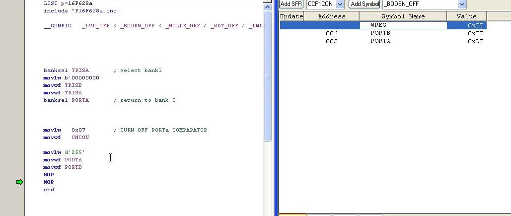

My head is spinning, please help.
movlw d'255'
movwf PORTA
movwf PORTB
when I 'watch' them I see that WREG goes to 255, PORTB goes to 255 but PORTA goes to 208.
I was expecting them both to go to 255.
What am I not understanding?
Thanks.

Thanks for the reply
chip is PIC16F628A
as for digital/analogue/comparator im not sure.
these are my only lines

The code below will load FF to PORTA, however not all pins on the 628A can be used as outputs.
First you must set up the Configuration line to Set the Internal Oscillator On so allowing RA6 and RA7 to be used as Digital pins instead of an input for the crystal oscillator.
You then must turn off the default Comparator function, to allow all PortA pins to be used as Digital outputs
Finally RA5 can only be used as a Digital Input, and only when Mclre is turned off in the Config.
So the final result on PortA for the 255 input will be 0xDF or 223. No value in bit RA5
You are just using the code in the most basic way possible, have a look at the TEMPLATE file for the 628A in MPlab /Asm directories, which give you all the basics.
