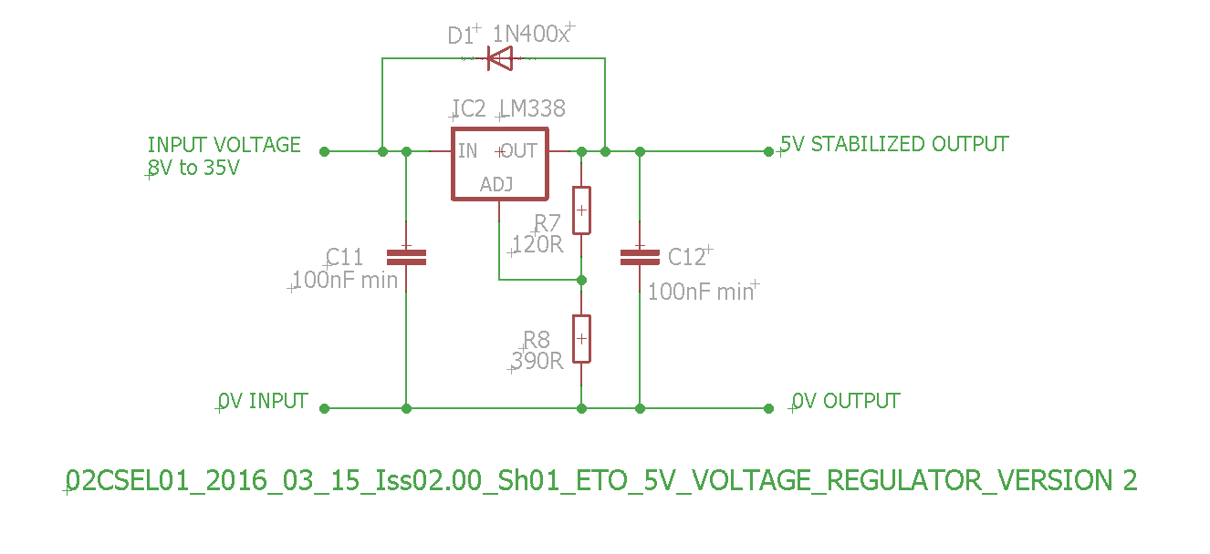

I have two 3,300uF capacitors rated 50V is that too much or would that be alright? I'd like ultra stable voltage output that doesnt drop with increase in load. but I want to use a high power 3-5A regulator so i have plenty of headroom with less heat generated by the regulator.
Can it work like that?

One 3,300uF capacitor on the input would be good and would ensure that the ripple voltage at the input would be low. But you would still need a 330nF low loss capacitor (ceramic, polycarbonate) in parallel with a big capacitor like that to handle the high frequency filtering. Let us know which of the regulator chips you are going to use and we will be able to work out a definitive design for you. The two higher current regulators, being low dropout types, as ronsimpson said, are much more touchy about capacitors than the 7805.

Hi real,
Here is a 5V voltage regulator that uses a variable 5A three terminal regulator which is less critical of capacitance values than the low drop out (LDO) types. Although the LM338 is not a LDO regulator it will still have a comparably low drop out voltage at currents up to around 2A.
So long as you fit the two capacitors shown, which must be ceramic types, you can fit whatever additional capacitors you wish.
Being adjustable, later on you can set the output voltage to 5.25V which, when line drops are taken into account, is best for a USB source voltage. That will give you better charging of USB devices, mobile phones etc.
The LM338 voltage regulator costs around the £2 UK mark.
