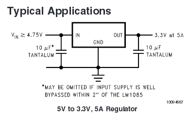

I try to get this one? and how easy would it be able to set up with minimal components? minimal filtering components? is it possible to use it by itself even?
From the data sheet. This is using the 5 volt version not the adjustable!
This is the minimal component circuit.
This is a "LDO" (Low Drop Out) part and they need these capacitors more than a non-LDO version.
If you have 10V in and 5V out at 1A there will be 5 watts loss in the regulator. It will be too hot with out a heat sink. A big heat sink.

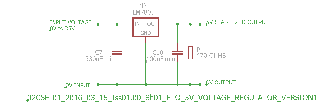

Why bother with any of this when a genuine 7805 costs ~$0.44?
OBSOLETE: PLEASE SEE POST #26
ERRATA
(1) Connect a 1N400x (x= 2 to 9) rectifier diode, cathode to the regulator input and anode to the regulator output. Any 1A or more, 50V or more rectifier diode will be suitable. This diode protects the regulator when the power is switched off.
NOTES
(1) The circuit will provide a constant 5V for load currents from 0A to 1A. Above around 1A drain the output voltage will drop to 0V. By fitting different three terminal regulators the maximum output current can be increased to 3A or 5A- see data sheets below.
(2) The three terminal regulator should be bolted to a heat sink using insulating washers and a mica washer between the lower metal face of the regulator case and the heat sink. A thin coating of thermal grease should be smeared on both faces of the mica washer.
DATA SHEETS
(1) LM78xx Voltage Regulator (1A output. Input voltage range 8V to 35V)
https://www.fairchildsemi.com/datasheets/LM/LM7805.pdf
(2) LM1085-5 (3A output. Input voltage range 6.5V to 29V)
(3) LM1084-5 (5A output. Input voltage range 6.5V to 29V)
What are you Driving with this 5 Volts?
And What Current do you really Need?
Noise is only a Problem when driving certain Items.
(Amplifiers, Transmitters, ETC, But not for things like Relays or Solenoids)
Considering your Input Supply Voltage is 9 to 10 Volts, It Doesn't require a Low Drop Out Regulator.
Any 5 Volt Regulator should be Ok.
I wanted to power a 5V usb hub with a very reliable 5V that doesnt drop voltage much on load Noise isn't a large issue but I just want the voltage to be reasonably stable at no load and high load. (voltage increases back up to 5V when load is increased to keep 5V on the output and decreases V to 5V when theres no load or very small load.) and has plenty overhead for charging a phone. running xbox controllers and such so that windows doesn't report insufficient power issues.
because all my usb ports are filled up with things.
I have a 2A power supply (switch on the front to change output voltage between 3V 5V 6V 6.5V 7V 7.5V and such up to 11.7V but i checked the voltage on its 5V setting and it was much too high to be safe plugged into anything that requires a consistant 5V like a usb hub.
trying to run my usb headphones off the usb hub off that setting is unreliable and makes the bottom half of the audio waveform below 0V completely cut off! and even does that to the microphone. so thats why I want a consistant 5V output. but my computer can't supply enough current to all the devices at once.
Almost Any 5 Volt Regulator will be OK for your needs.
Even a Cheap 7805, With a Suitable Heat Sink.
But Considering your POOR Quality 2 Amp Power Supply, I would recommend Including Both the Input and Output Capacitors on the Regulator.
