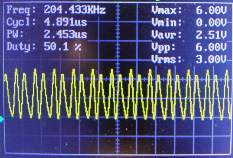

Using my toy oscilloscope, I just got this:
That speed is at the maximum specified for the toy scope, so I didn't expect to see much, but the stats are about right.

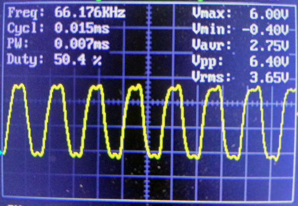

When I slow it down with
  OCR2A = 254;
  OCR2B = 127;
I get this, which is a pretty decent waveform considering it is a $30 scope.
Of course, I may have messed something up, but I highly recommend those two references that I posted, plus the data sheet.
